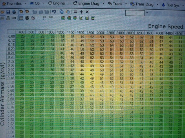

Low load highway driving isn't the same when its 293ci vs 346, 364 or higher... A 4.8 is going to be loaded more to maintain speed, especially at 85mph or pulling a boat... And E85 burns slower so your EGTs will be higher as well. Your cruise timing does look a little low though, Rob. Add some and you might see some better mileage and torque at cruise, and cooler exhaust pipes.

Copy from hptuners, paste special as transpose in excel, copy that and paste back into hptuners. The labels will be backwards though...

im at 50* under no load and 45* cruising in my car that runs on E85, i have 34* in it to 6psi of boost then it ramps down to 20* on 25psi.
needs more timing to start the burn sooner in the cylinder.

You'll notice a huge gain in torque once you re work that spark table. I know I sure did going from low 30s to around 42-43* at 60-70 mph cruise...

I forgot I don't have Internet at home so this is the best I can do...
