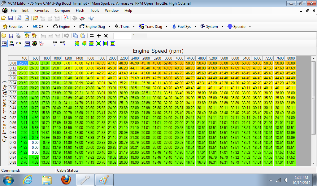

Originally Posted by Atomic
Low load timing should be at the top of 30s or 40s
So cruise timing with a turbo should be roughly the same as a NA tune? I think mine runs mid 30's while cruising. The reason i ask is i am adding boost soon, my KB kit is on order
Old Oct 10, 2012 | 12:32 PM
  #172
nonnieselman's Avatar
Joined: Oct 2004
Posts: 14,068
From: Crystal Springs, MS
Your vacuum spark/fuel tables will be the same. Im cruisin in the mid 40s with mid-high 15afr.
I used my old N/A scans to see what the max gr/cyl was and started pullin timing there. And started adding fuel in the 85-90kpa range

Got the old tuning laptop with me on the road lol. Anyways here's the map if someone wants to take a look or share theirs for feedback.

I hate when The tables are opposite. Efi live has rpm as rows and gr/cyl as columns. Haha
Id have to sit there and study yours to figure out whats goin on

Yea it is damn confusing reading EFI live tunes. I feel cross-eyed. haha

You definitely need more advance cruising. I'm mid 40s when I'm cruising at 70mph...
That's about .40 g/cyl if I remember correctly

Hrmm, it does have a little skip in her step sometimes. I always figured it was a 2 range colder/small plug gap on e85 kind of deal. Maybe through my 4000x flashes some timing got taken out of that area. Mind sharing your idle/cruise timing. I think all of that area for me is off.

I have the 02 custom operating system, I pretty have a na tune on mine till it hits past what na map is, then I start pulling timing off and adding fuel. I wana say it's high 30s maybe even 40s at real light throddle. Then like 23 degrees at 1#, 21 at 10#, and 17 at 20#

id post mine up but its gonna take some crossing to understand it..
