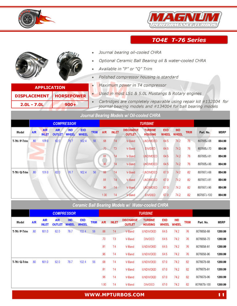

That magnum has a 65mm turbine exducer right? That's the same as my on3. I'm really curious about your back pressure results. I know its killing me just don't know how much. I'm gonna go with a s475 with a 87 wheel

No the q trim magnum has a 67mm exducer. The p trim has a 64.5 exducer I think.

Looky there

I still can't get over how sexy those specs are.
I still think I'm going to run with some twin on3 cheapos. Maybe something under 60mm.
