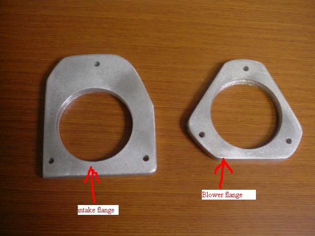

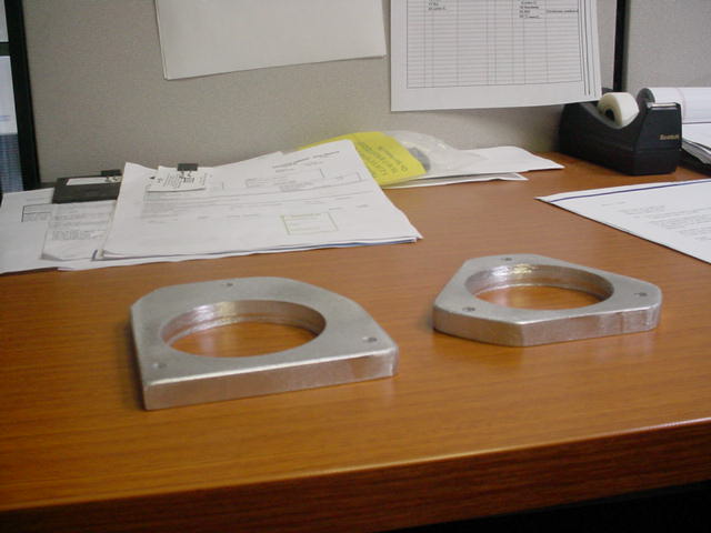

Got the Whipple output blower flange and the intake inlet flange done. Welding the pipe in tomorrow. 1/2" stock might have been overkill, but it should be fine.
