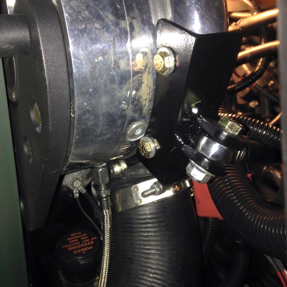

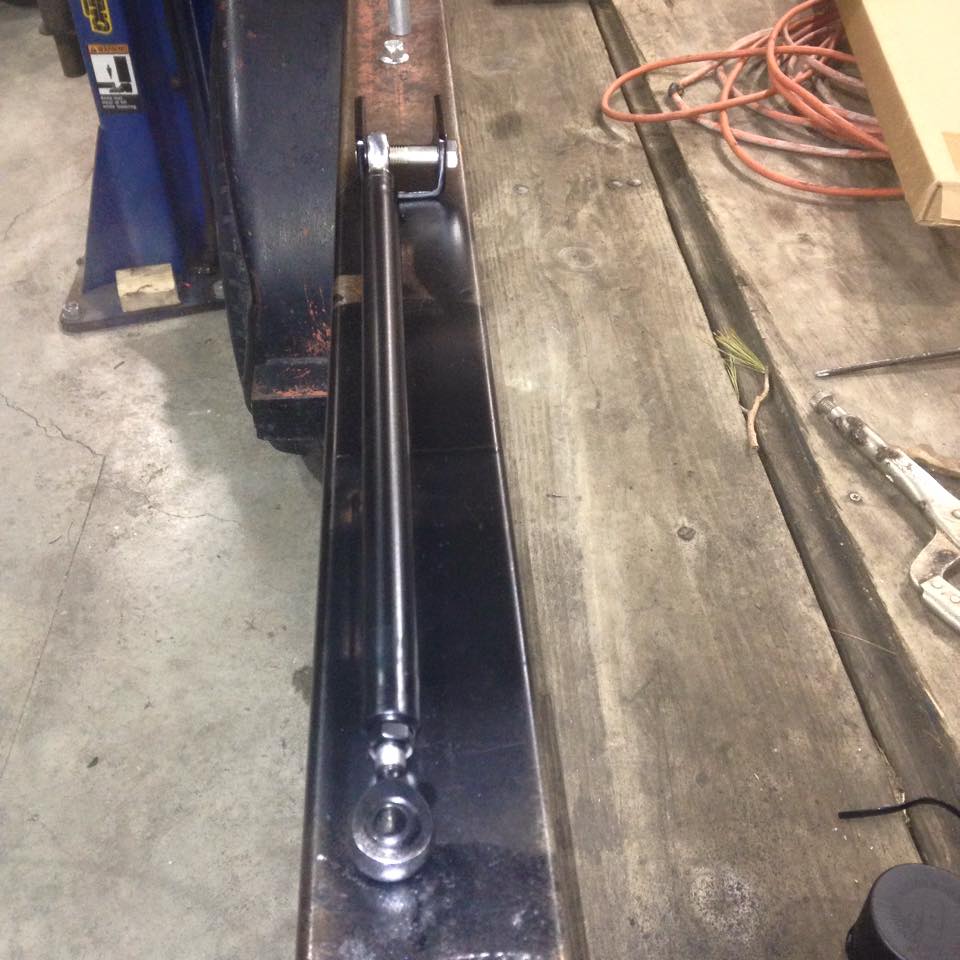

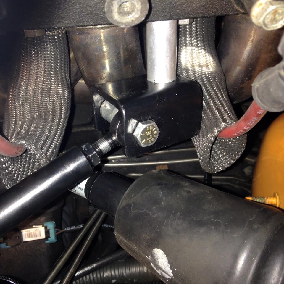

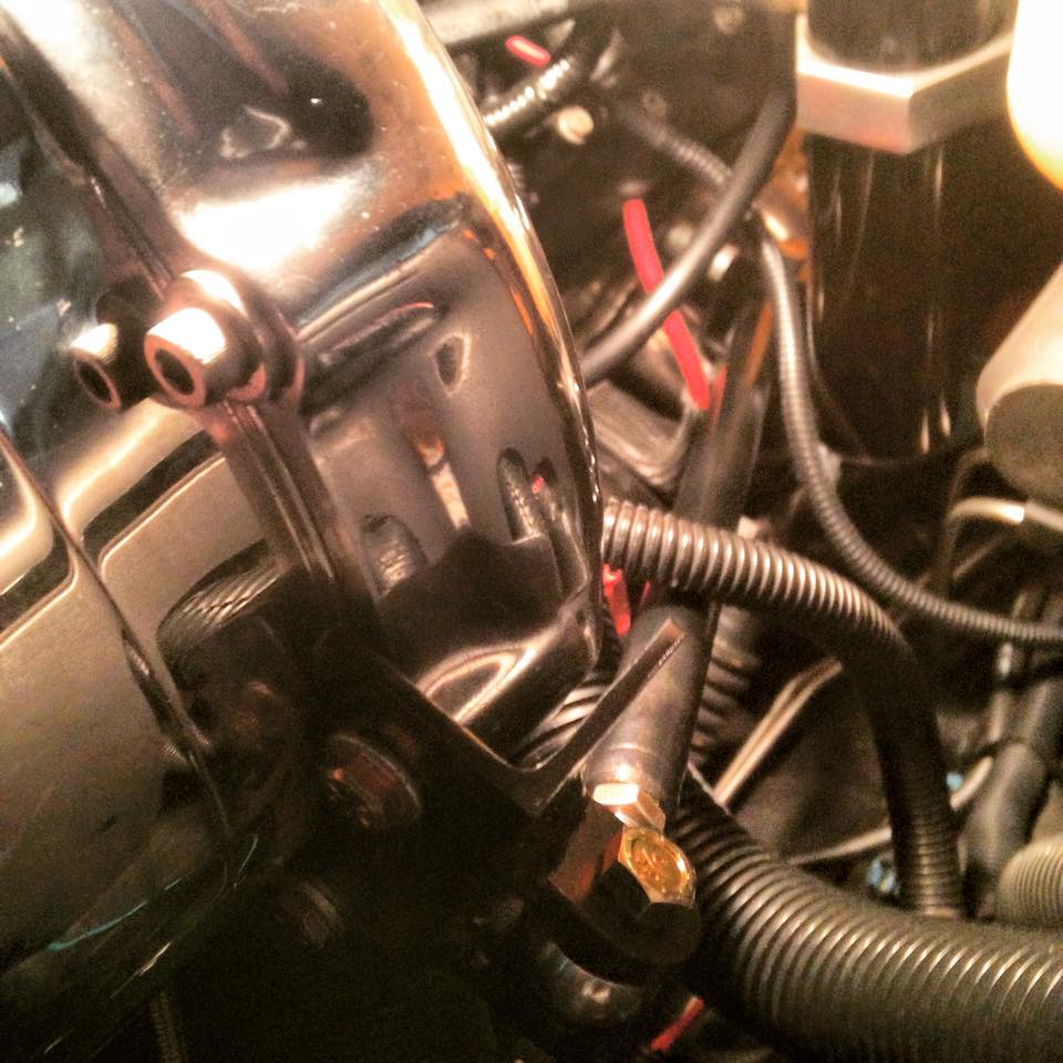

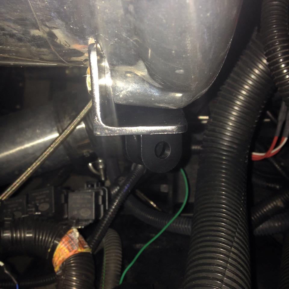

i was sick of dealing with the bracket flexing so i made a brace to do away with it pretty simple seems to work pretty good

Does the bracket flex and then the belt comes off?
Old Feb 18, 2015 | 09:10 PM
02_Orange_D1SC's Avatar
Fastest D1 Procharged Truck
iTrader: (30)
Joined: Mar 2007
Posts: 3,132
From: mASSHOLE
yup the procharger bracket flexes like a **** I've been fighting belt issues for awhile now hopefully this helps

How is the cylinder head end bracket attached? Is it just a bolt directly in the head with a spacer?
Old Feb 19, 2015 | 04:54 PM
iTrader: (30)
Joined: Mar 2007
Posts: 3,132
From: mASSHOLE
Originally Posted by George C....
What bracket ?
I run the early bracket with a 3.2 pulley and no belt issues or flexing
the early style bracket is a better design imo the newer one is junk
yup

damn and everything I read stated the early bracket was none for belt slip cause of the Alt and its adjusters but that isnt case with mine as i uses the Large Alt and those adjusters are locked tight cause of size
how bad is the flex
Old Feb 19, 2015 | 05:37 PM
iTrader: (30)
Joined: Mar 2007
Posts: 3,132
From: mASSHOLE
how bad is the flex
pretty bad i can stand in front of my truck and pull on the bracket and watch it move a good 1/4 inch or even more
i wish i did the House of boost DD setup but I'm pretty sure this brace should help out a ton
