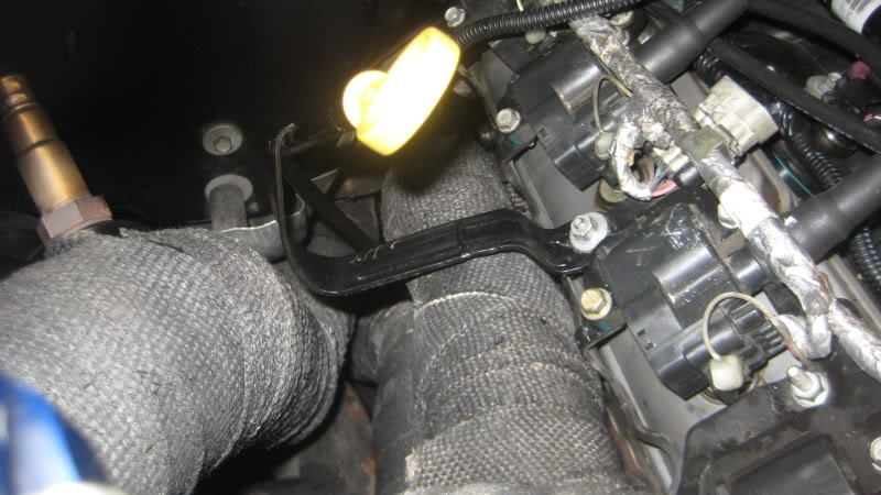

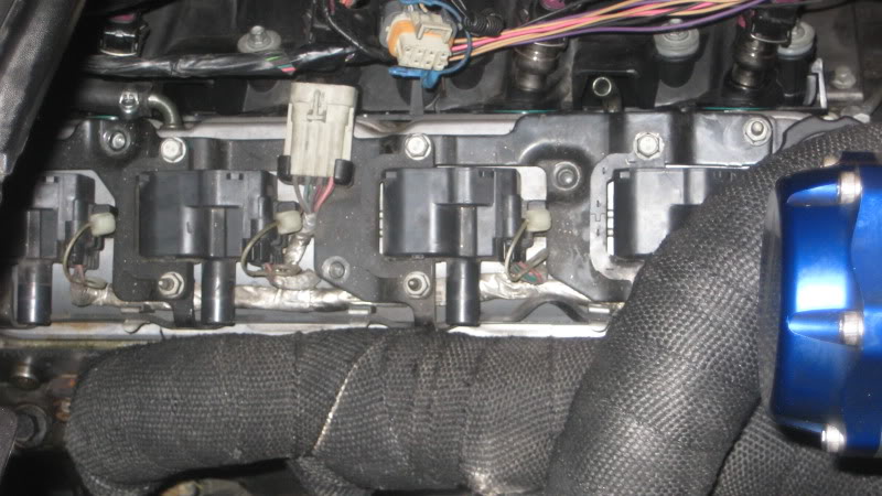

I am running a Nelson Performance front mount with a flipped manifold. This was his third set of this design, he has since changed the location of the turbo, but it still uses the flipped manifold. My turbo is a 70/96. My down pipe is now routed down the outside of the pass side frame rail.
The coils would NOT fit in the normal location. To use the exsting brackets etc I had to flip the coils upside down and make new wires. No big deal
