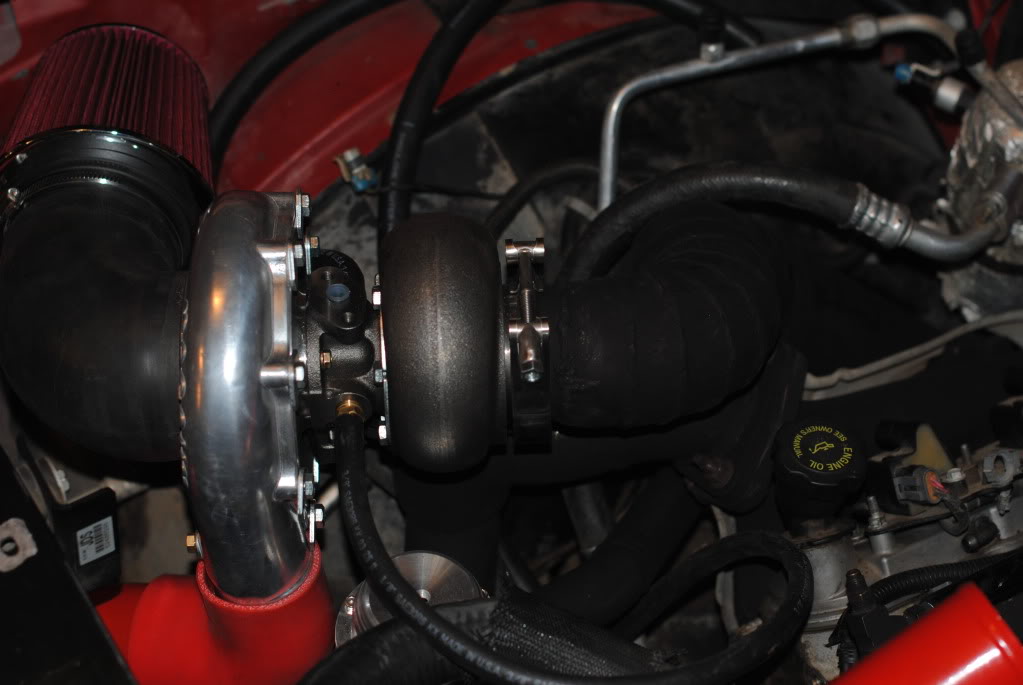

I flipped my stock truck manifolds, kept the AC and ran across the front. More build pics here
https://www.performancetrucks.net/fo...t-more-491848/
That nice work. You have the hot pipe on the outside of the AC lines. I like the little coolant overflow tank you got there. I just blocked off the TB warmer port. Guess you not running the stock throttle body either. What size turbo looks like something that feed a 4.8. Thanks for the input.

Thanks, Yup, the AC line drops down to the compressor before the merge, haven't had any heat issues with it. Its a magnum t70, .68a/r feeding a 5.3l. Spools very quick and is a blast to drive on the street.

Wow your turbo is bigger than it looks in the pic. looks like a lot of fun.

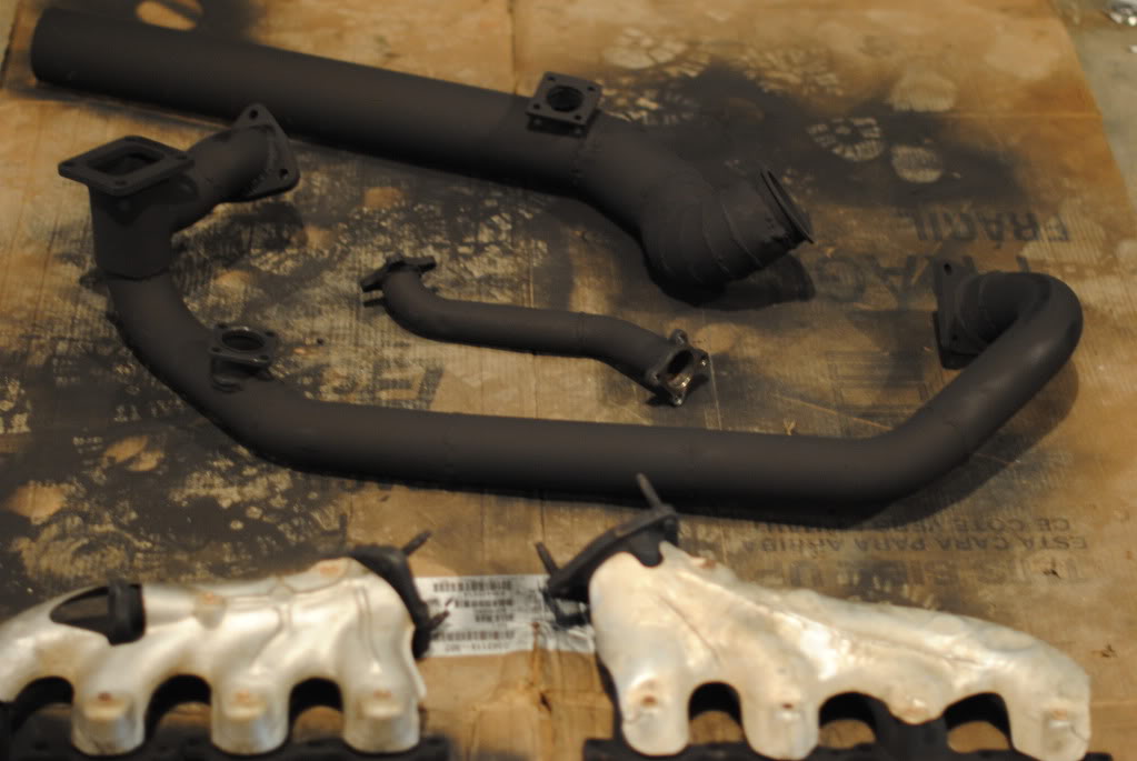

Not the greatest in the world but its been working real good so far, got the stock truck manifold up and forward on the driver side and a 01 fbody manifold on the passenger side.

Looks good what's the small cross over pipe for balancing pressure?

thats the wastegate plumbing i believe...

That's definitely not a pipe for a waste gate. I bought most of my cold side pipe from eBay and cut it. You need to go get it beaded after you cut it thought. Make sure you use t-bolt clamps, not worm gear on all your silicone.

Yeah the pipe is for the waist gate, I built it so I could use that to plum it into the down pipe or flip it around and have it into open air, I built a second pipe to use the gos straight down when its turned around into open air.
