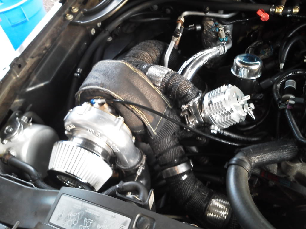

Anyone flipped their passenger side manifold

mine is the same as davids accept im running a gt45 turbo.

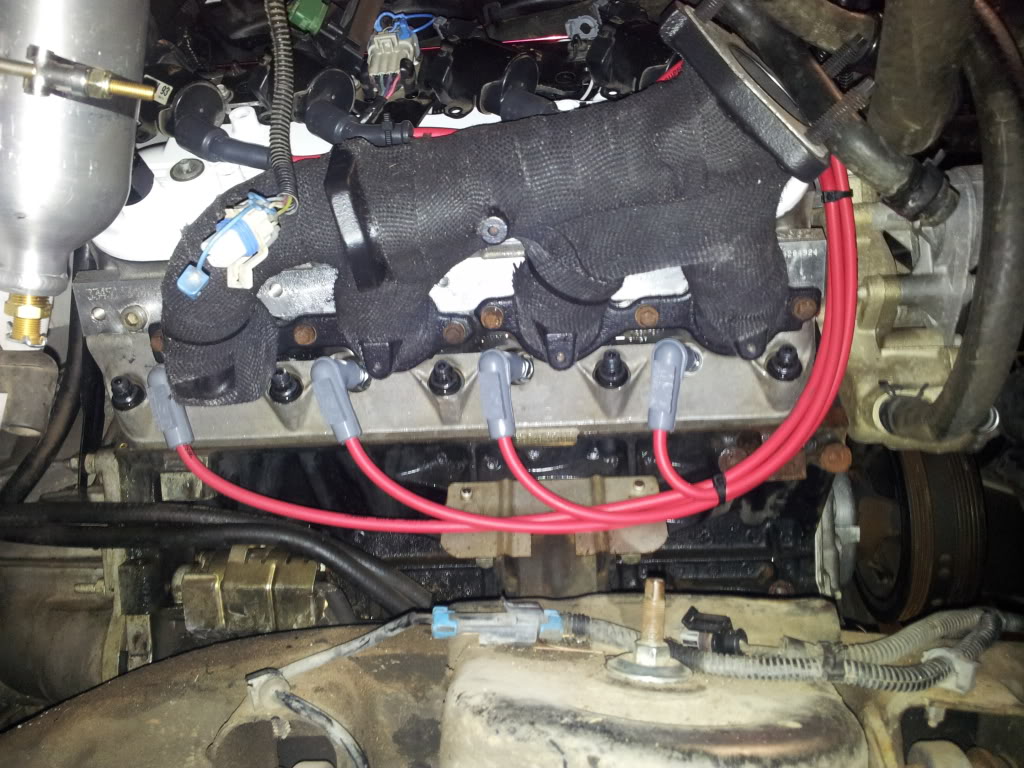

Do you guys need to put any over the plug wires to keep them from melting?

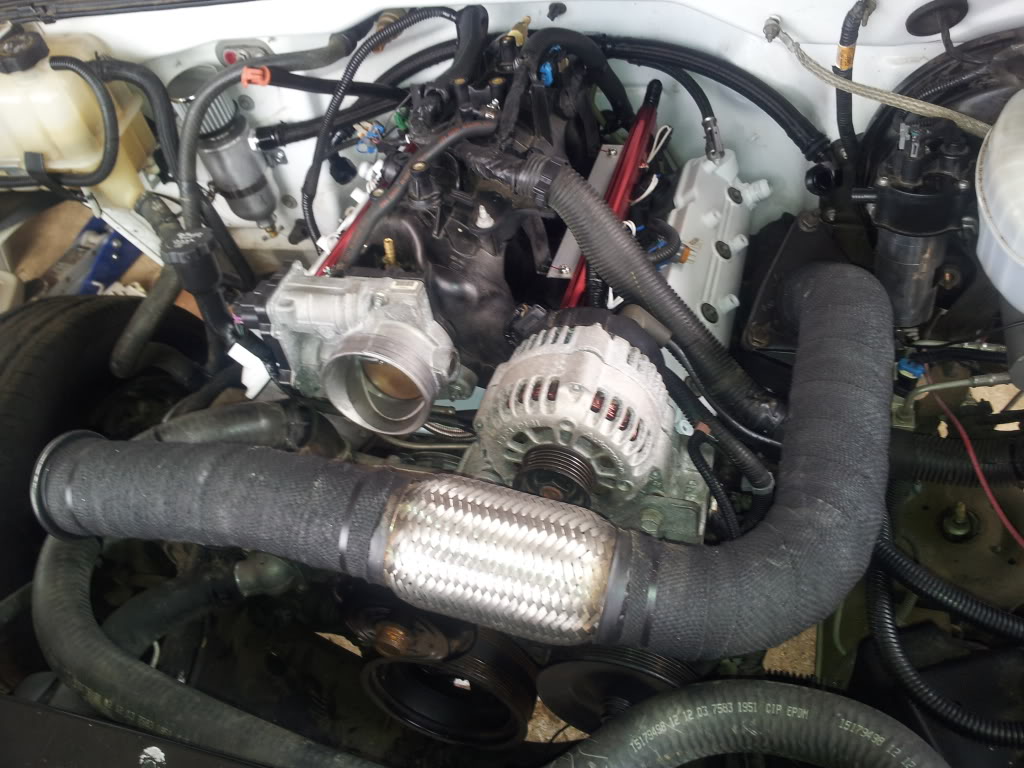

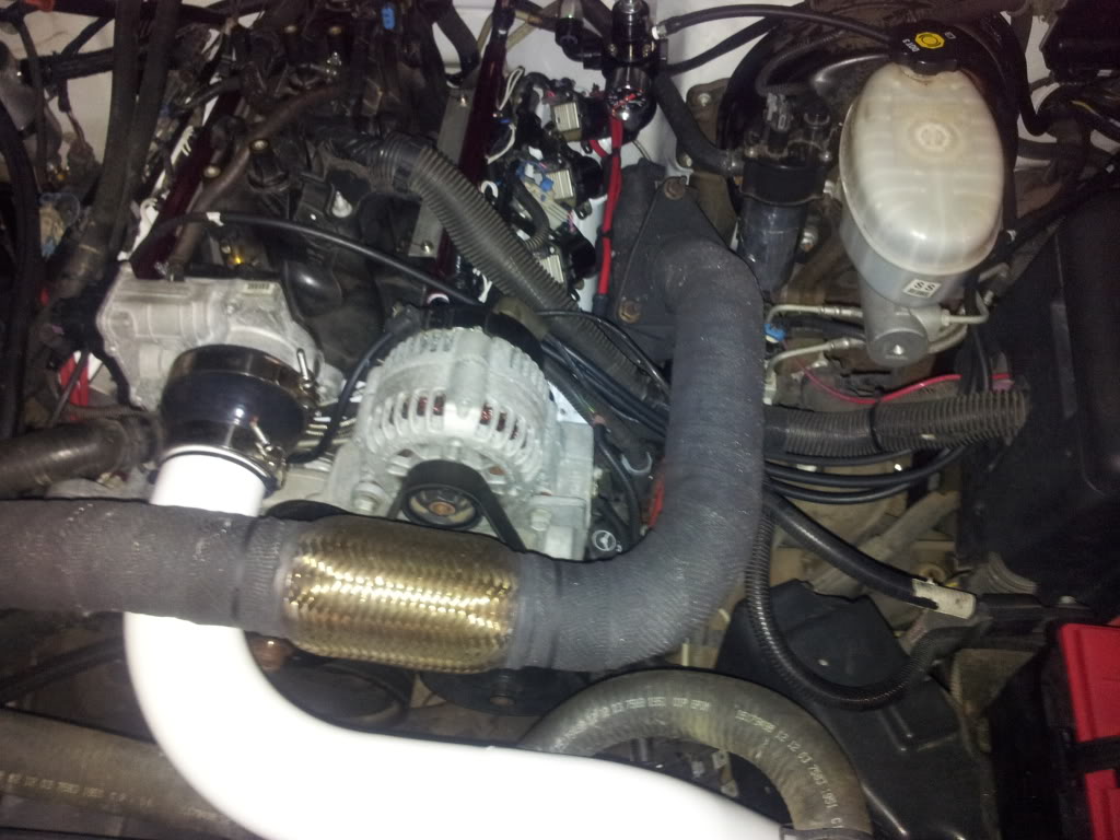

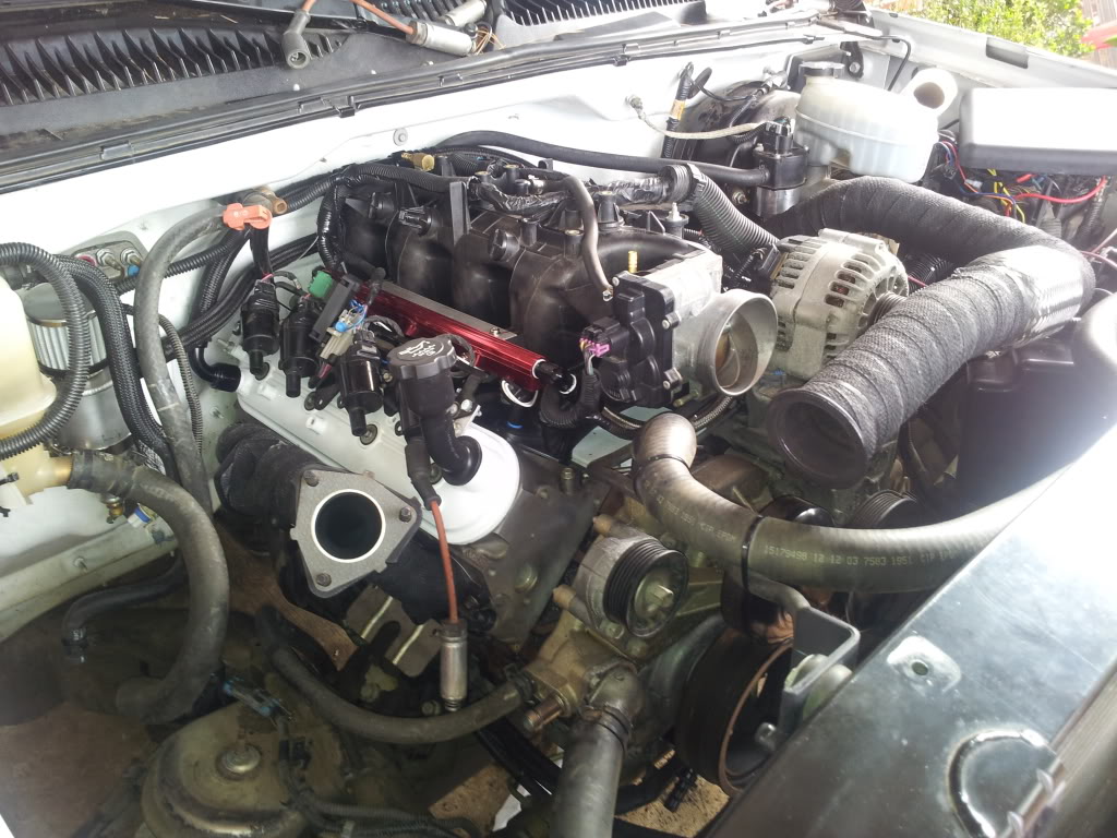

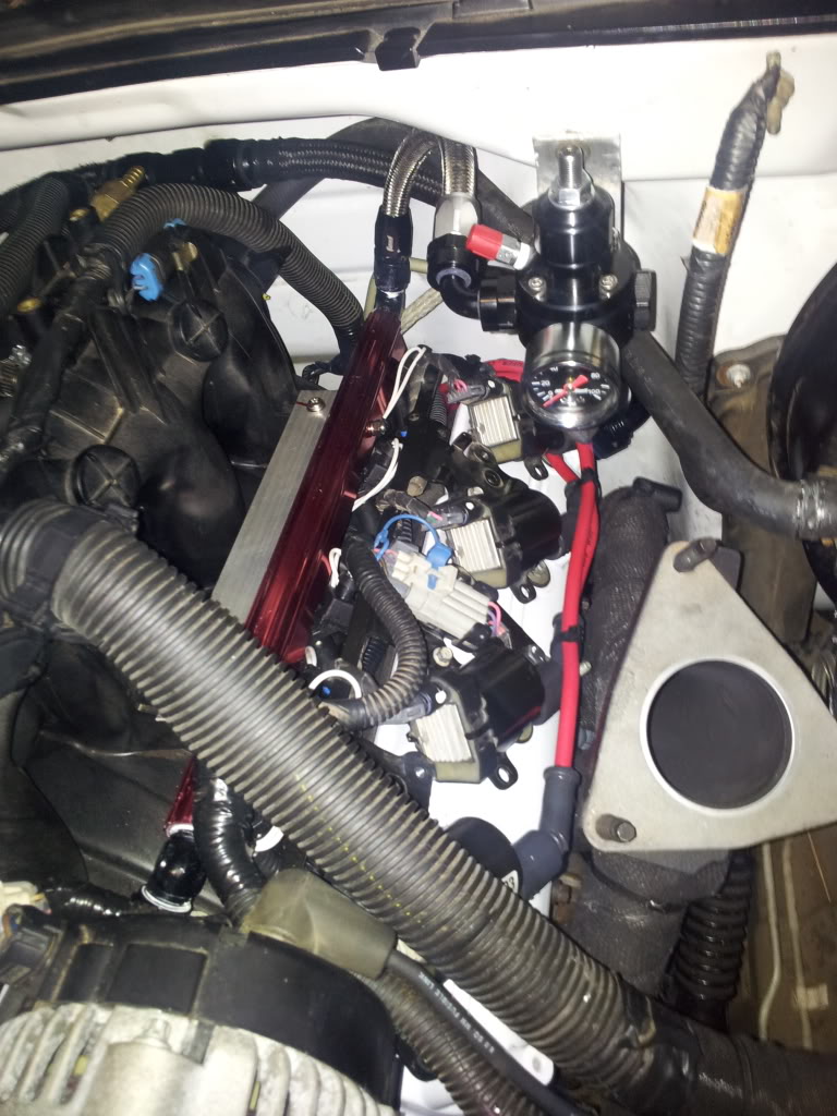

Here is mine I used manifolds from an 02 LS1 camaro and both of mine are flipped up

Like David said, mine works very well, but it is different than just about everybody else lol. Its not the prettiest but in person, its pretty cool looking, just not as clean as putting the crossover behind the engine. Lots of ways to skin a cat

Thanks for all the pics they help big time. I like coming across the front with the driver side manifold because you use a lot less hot pipe. think i may turn both of mine round now. Looked like you eliminated your ac. Im planning on keeping mine so that will take a little work as well.

Yea I dont have A/C but Im pretty sure the compressor would work just fine with my setup

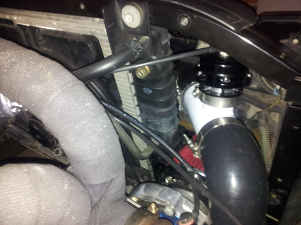

I flipped my stock truck manifolds, kept the AC and ran across the front. More build pics here
https://www.performancetrucks.net/fo...t-more-491848/
