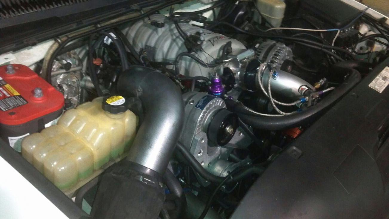

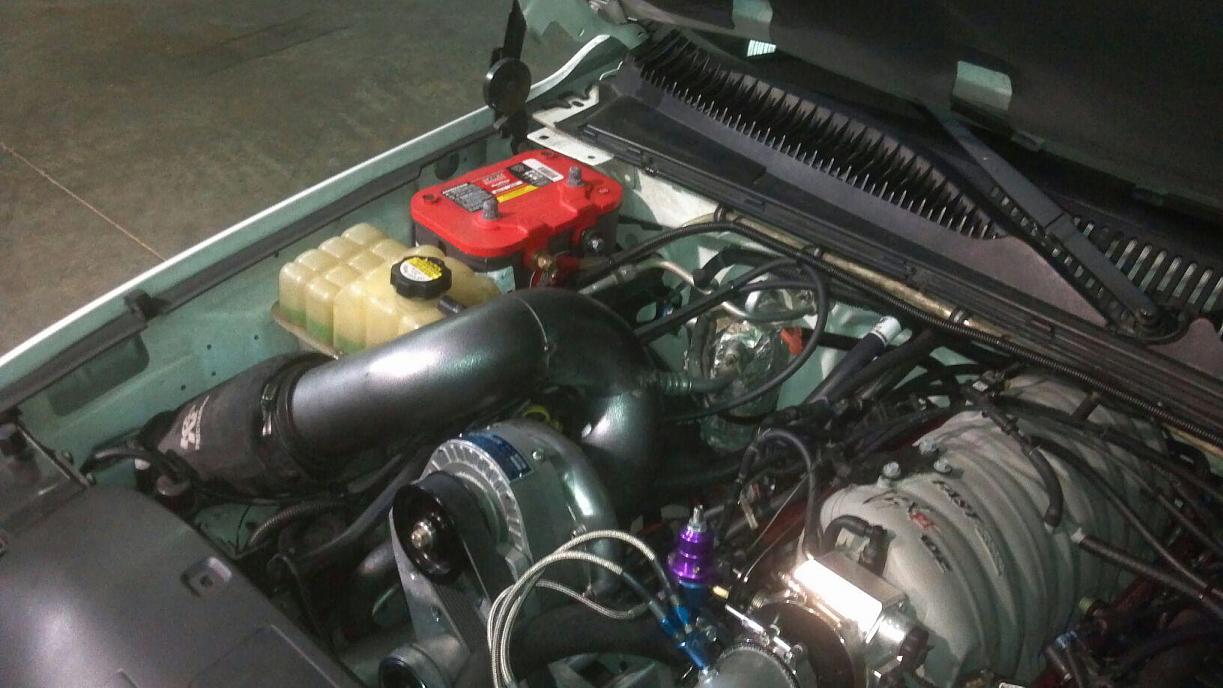

Fighting high IAT'S that we want to get under control first...and then add Mr. Freeze.
Got the fresh air intake completed today.

Just my opinion.........but you just killed that D1sc.

Blown why is that?

It aint gonna like breathing through that at all. I could be wrong, but next time your on the dyno, when your finished tuning, pull it off and make another pull. It'll likely pick up significant power and boost.
Prochargers hate tubing cold air systems.
