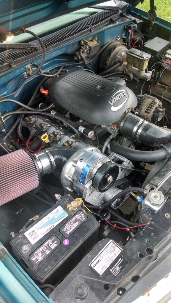

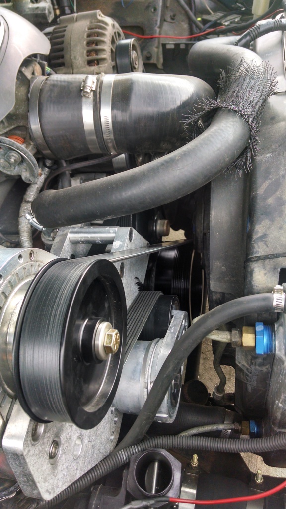

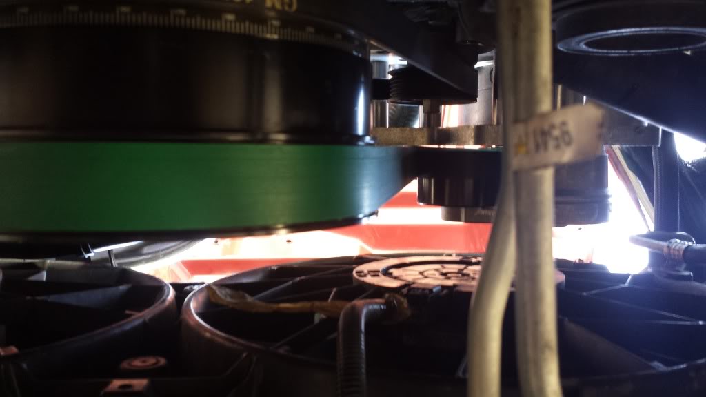

got a set of holley valve covers for free and got the HOB bracket and F1-a mounted and ductwork ran, still need to mount the big red valve and run the fuel system, just waiting on fittings from summit.

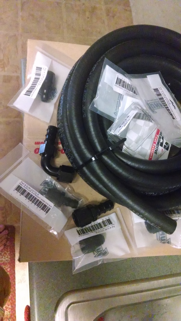

and the Garden hose i ordered haha

Haulass350,on your 3rd pic looks like the belt is hitting the bottom of the bracket by the tensioner, mines was like that but a cut about 1/8" off the all the spacer between the blower and middle bracket. Here's a pic from under the truck before Name:  20140511_142907.jpg
yeah it rubs a little bit, Shaun @ HOB is supposed to be looking for a shouldered pulley to help stop it.
