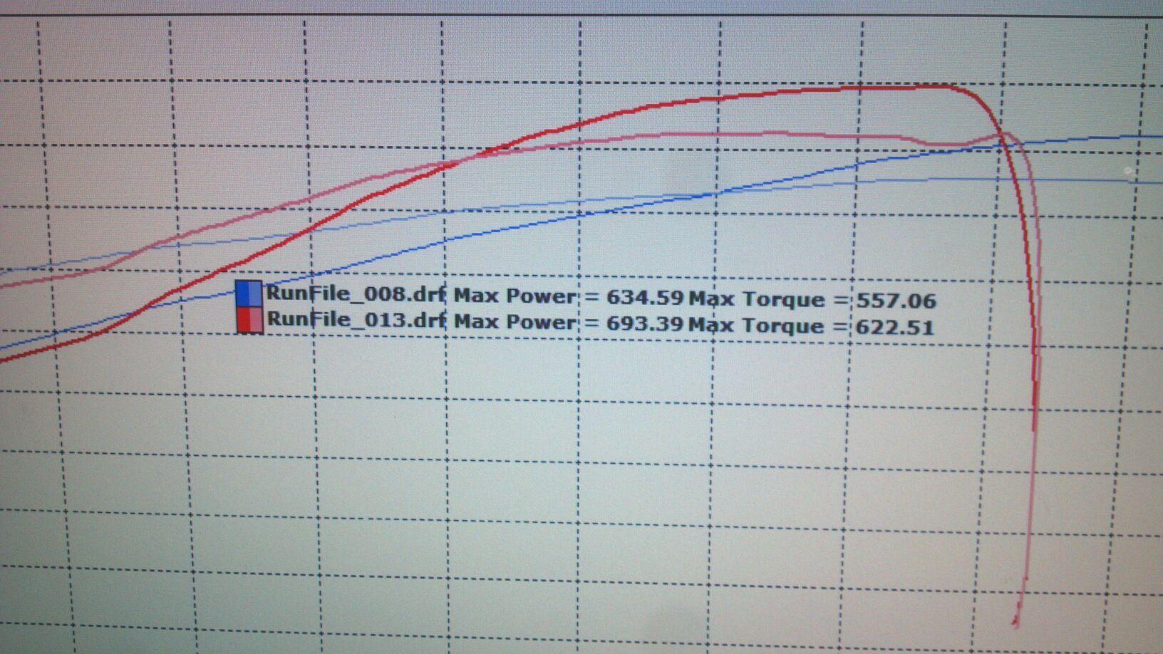

Just rcv'd update from dyno:
IAT after (2) pulls last week w/ filter directly on compressor inlet - 170° (617hp / 542tq)
IAT after (2) pulls today w/ "cold air pipe" - 128° (635hp / 557tq)
oh...and no belt slip
edit: It does appear that ambient temp last Thursday night was 10 - 15° warmer than ambient temp this afternoon...so I'm sure the cooler temp played into this some as well.

Only one I've been able to find so far...
693 / 623
Click on pic below for vid:
Attached Thumbnails Any ProCharger guys ever run the HoB DD bracket system?-693_623.jpg
