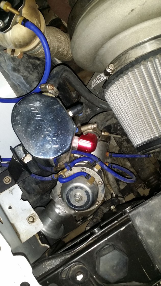

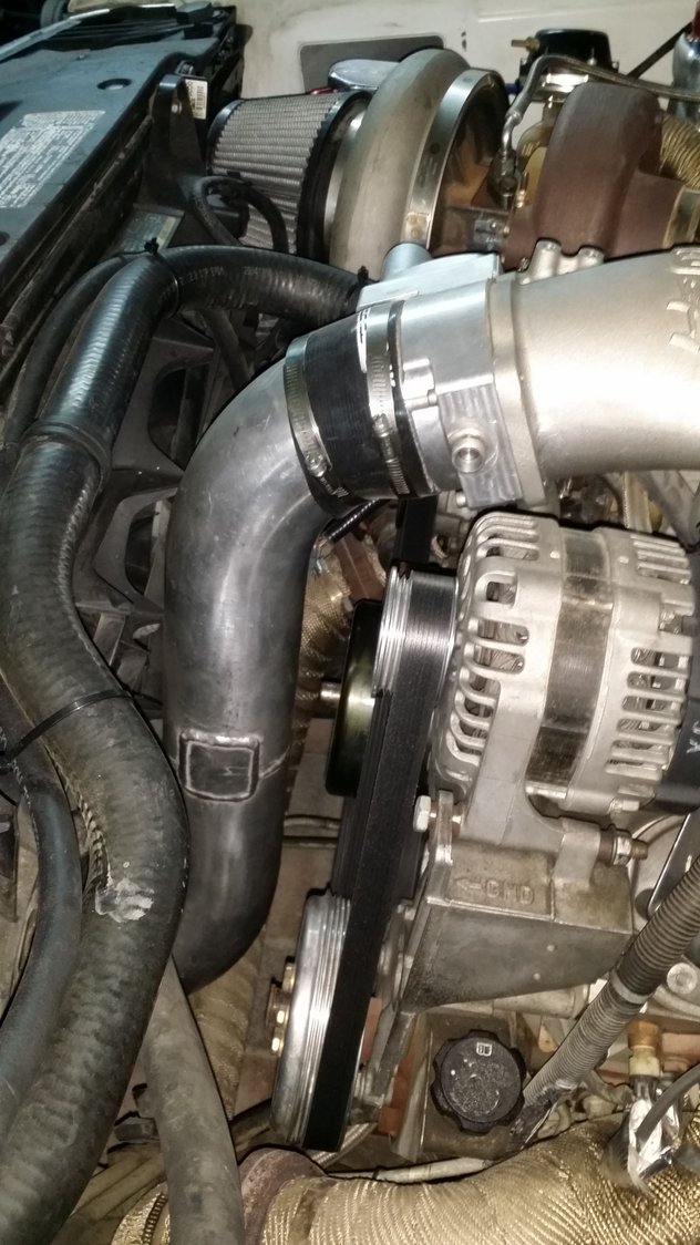

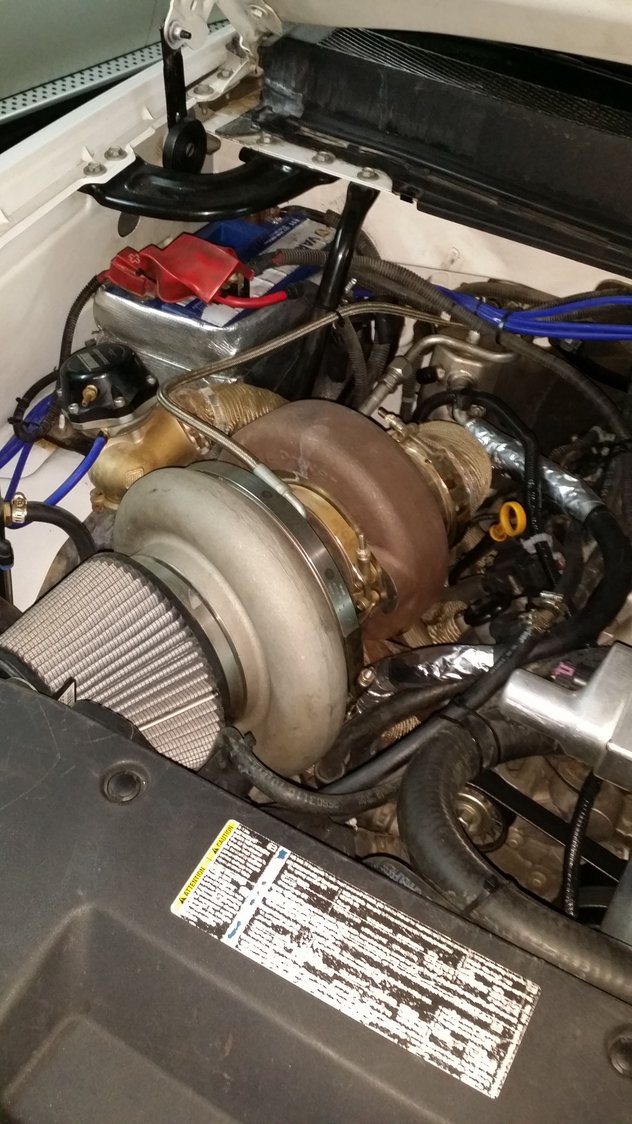

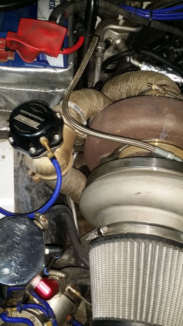

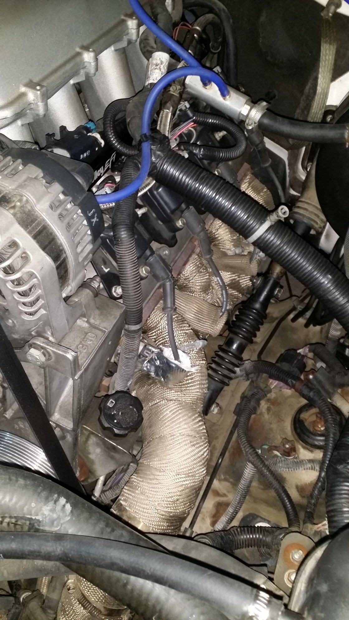

Here are the pics as promised. Let me know if you need more angles.

The turbo size is overkill, but not needed to change.
Your immediate needs would be to change the cam and put an aftermarket converter. For the amount of power runnning, stock converters will flex and take out the crankshaft.

A couple little things. Like everyone said, that turbo is huge. Talk to stock48 about a turbo when you are talking cams. If you start working that turbo the filter is way too small. Also in the pics it looks like the oil feed is laying against the wastegate. If so remove it before it makes a mess. Are you running a cat converter? If so that could be adding some restriction. You might consider a cutout to help move some exhaust.
