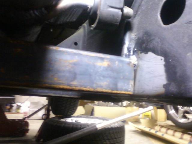

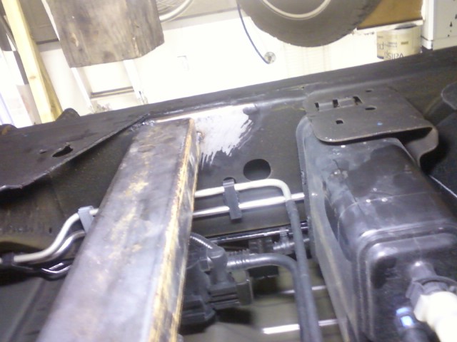

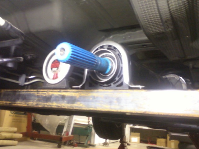

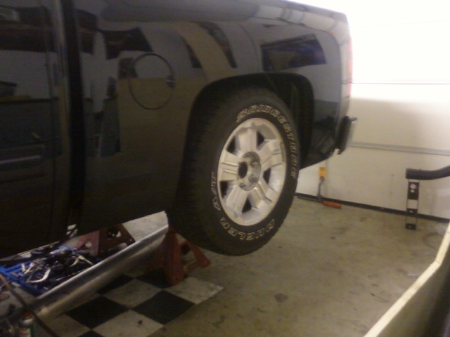

Well I been working on the truck some. I install the rough country 2/5 kit and added 2' spindles. And Im installing a crossmember and my 2 piece driveshaft.

What's up with the 2 piece drive shaft?

I have to go to the 2 piece because of the rpm/limit is 105 mph. I can spin the 2 piece faster.
