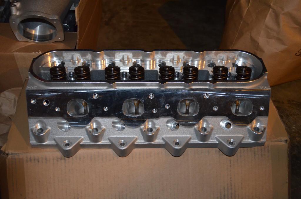

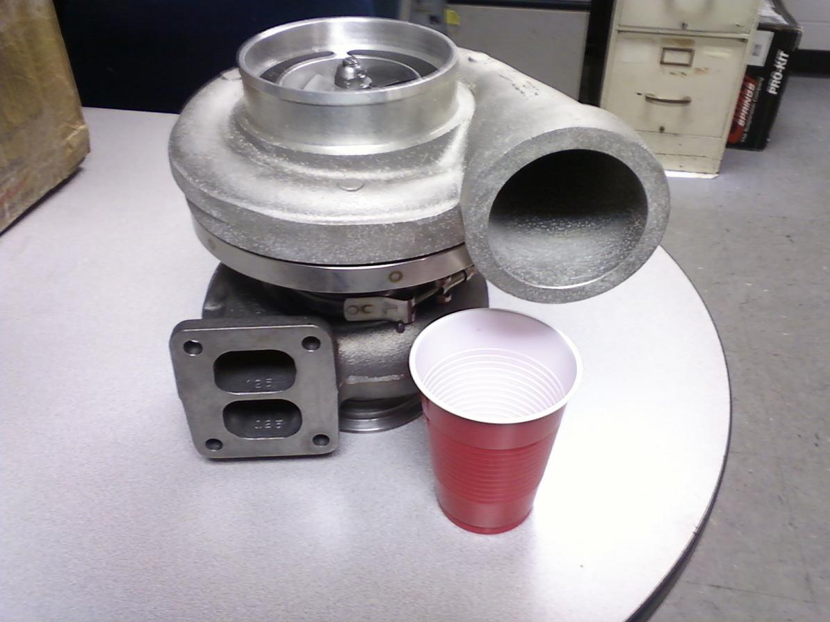

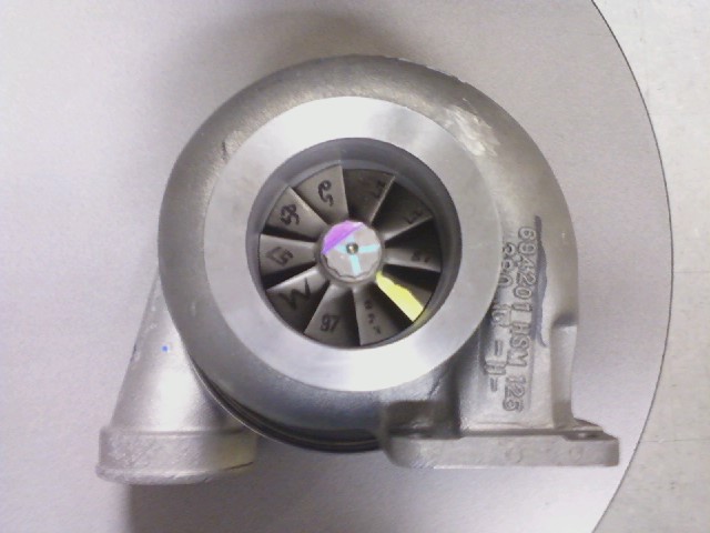

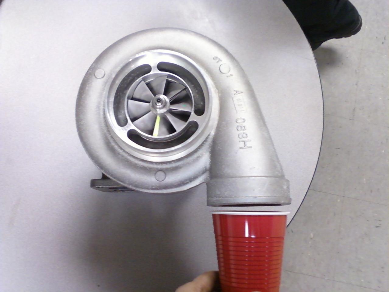

Guys a update all machine is about done. I had a little change in the plan I have TSP PRC 6 bolt head. And the new turbo is here do.

What turbo is that. Looks purdy big
it just a 80m with a 93turbine 1.25ar. I will do some trick porting and it will be a beast. I want to see what it will do. Then on to bigger things if you know what I mean.

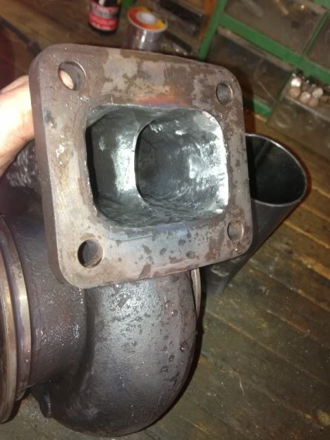

Port and knife edge the turbine housing. Helps a lot. I used a t4 gasket for a reference to know how far to go out in areas. Here's mine.
Not trying to thread hack. Can delete if you want.
