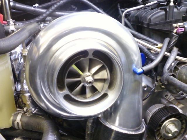

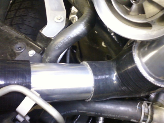

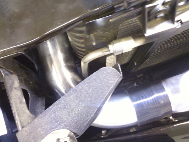

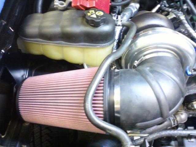

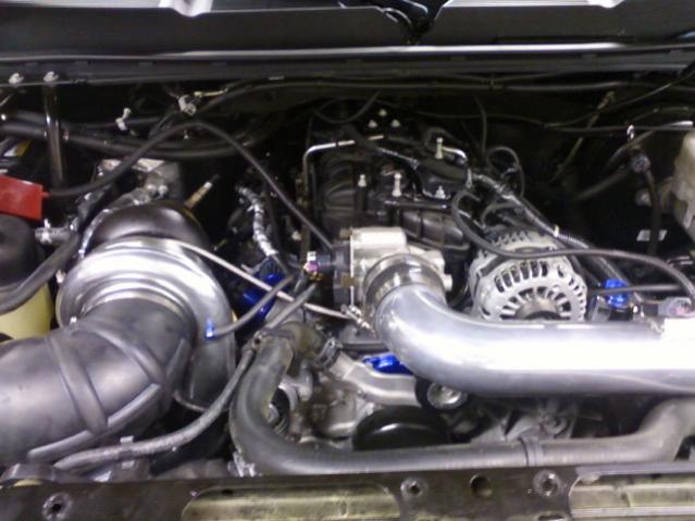

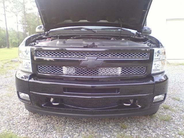

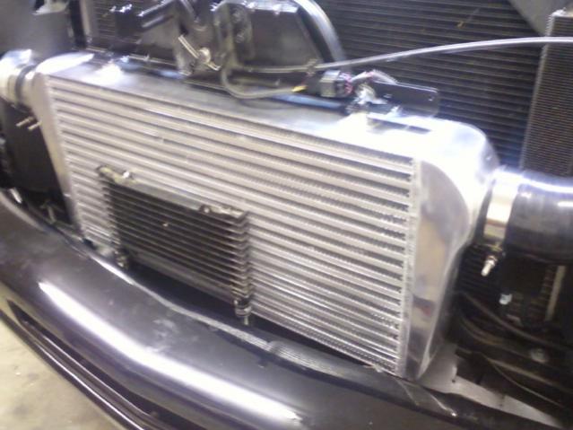

More pics!!!! The 3in inlet to the intercooler worked out great ordering a big intercooler tonight. I cant wait to start her up.

It started up!!!! idle hunting bad cold and hot it want idle at all. Tuning needed. But it sound great reving it up. I have a little water leak at the two plug I install in the head Dammit I knew I should have silicone them. But A easy fix. Install fuel pressure gage next and ordering fuel pump and then driveshaft.
