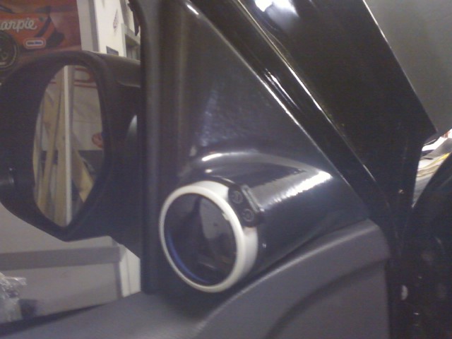

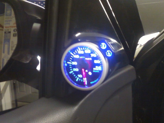

I installed my fuel pressure gauge and my door pod, turned out awesome. Still working on the suspension. Lowering and setup the 2 piece driveshaft. And looking at tires too.
