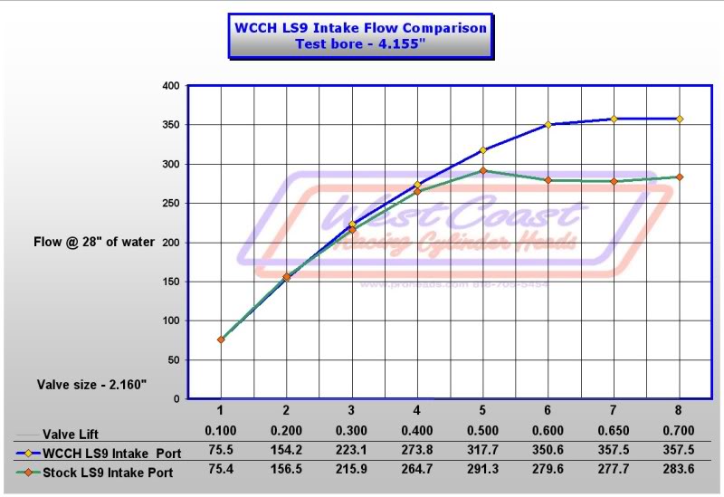

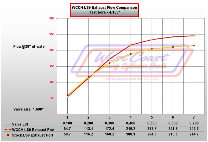

I didn't get a flow sheet but Richard said 350cfm @ .600 lift IIRC...
From his site:
LS9/LS3/LSA heads are the same, so Ive been told.
