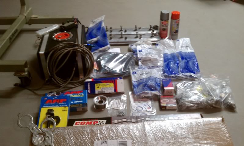

This is getting out of hand
Still waiting on the Pat G cam and pushrods to arrive then I will get the longblock going. Then I will turn my attention to the blower setup.
For those interested this is the cam spec's by PatG. I'm not sure if this is supossed to be secret like some of the other cam gurus around here
231/239 .598”/.610” 116LSA +1 advance
For the more technical see attachment...
thats a healthy cam! what attachment?
looking good bro!
