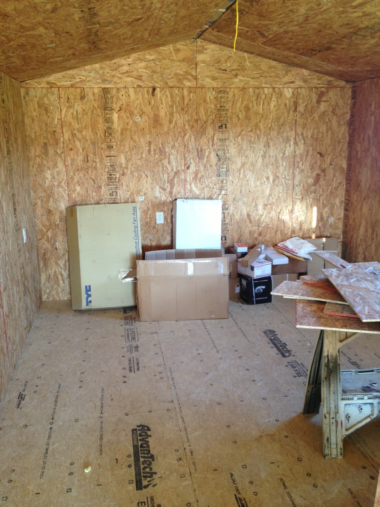

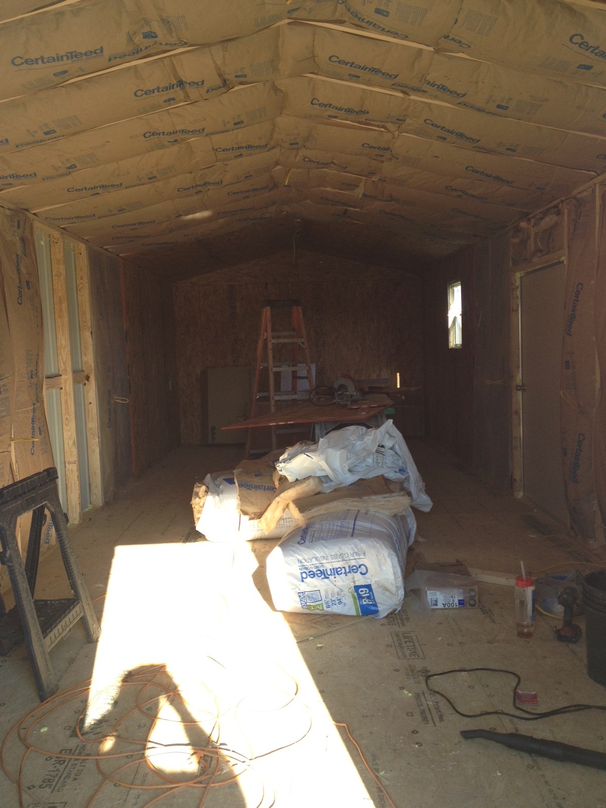

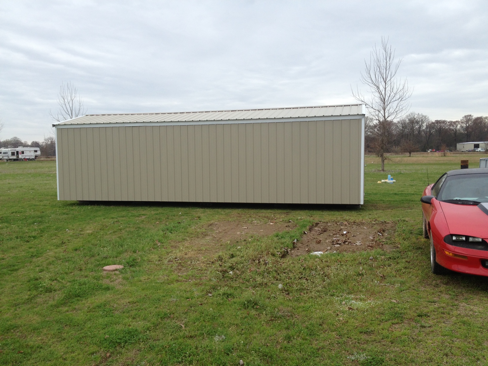

Well getting truck parts ordered was delayed for the last month or so. Been working on a 12x32 storage building. I did however order a DEI turbo blanket and 50' exhaust wrap this morning. Looking to order oil catch can system next. What will do the job? RX system looks good. Is it worth the money? $400 for dual valve kit w/ standard hose or $459 for monster can kit w/ standard hose. $40 for breather oil fill cap. Here's a few pics of current progress on the building and a few truck parts laying around.
