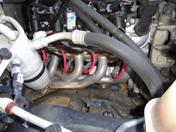

Header question. Truck currently has shorty headers(on the truck when i bought it).also got the stock manifold with the truck. Should I put stock manifold on driver side and sell the shorties or just use the shorty on the driver side?

Not sure what brand but here is a pic.
I'd sell the shorties and put the money to other things. The truck manifold has been old reliable way over 1000+ hp.

That's what I was thinking. Just wanted to make sure before they were gone!
