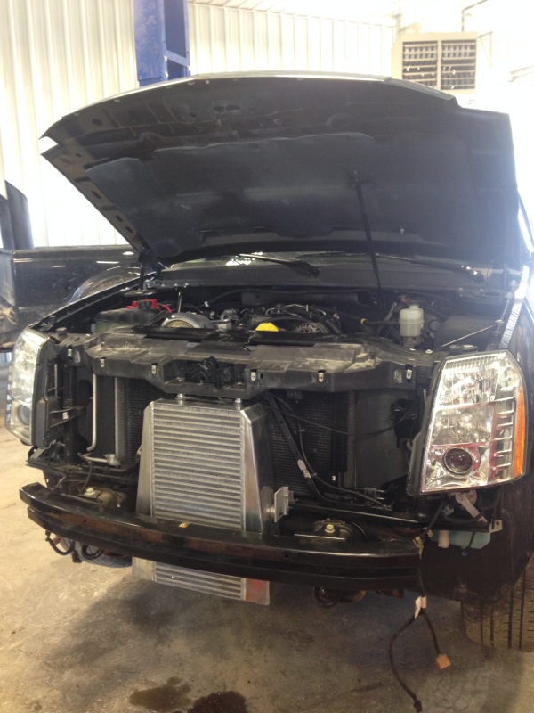

Here is a picture of my 5" from Rick.

^ I saw your thread last night as i searched deeper. I'm fairly confident that I'm going with Rick's race 5" kit. I believe it will be more than adequate for my power levels and the no hassle installations is a great influencing factor for me.
