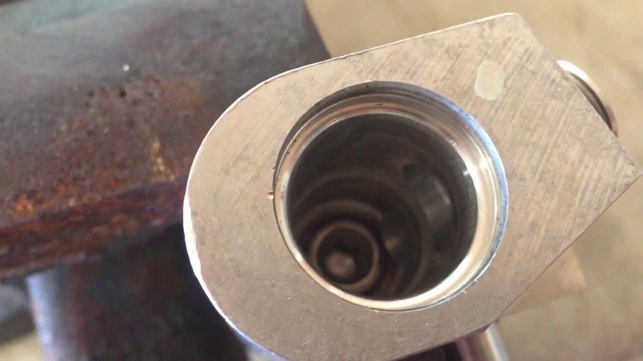

trans will hold for 700 it's not problem for you yet remove trans t-stat with 40k cooler should be good .
run the kit for a while first you never know what will go wrong
Trans T stat?

Originally Posted by smokinlmm
Trans T stat?
Oem will open around 180 and stay there until shoutdown with a converter and FI setup it will reach higher degrees faster and may go over 200 for normal driving .

Originally Posted by Boost-freak
no only for 14+
Interesting stuff. How much longer does it take the transmission to reach safe operating temp?
