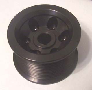

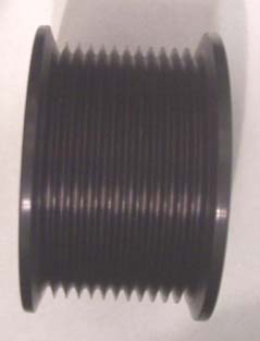

Here is some pics of a 12rib pulleys we built for a customer. No plans to build any more and I have 1 extra of these right now. It was a HUGE amount or work. A lot more then I thought I would be. LOL

Some JB weld and 2 normal pullies would have made easy work of it.
And weigh 4lbs. lol

Originally Posted by schino
Looks good rick. Whatd you do for the crank?
Customer picked up a 12rib crank pulley. Its a standalone drive so the oem stuff is still driven with a 6 rib.
Originally Posted by 05crew
what up rick..long time no talk....hope all is well, i see you still at it...lol. do you have a full 8rip setup for a tvs 1900? i have a interv.west crank pulley. just need the others.
All is good, I have trimmed way back from days of old. And its really paid off, in health and sanity.
Sorry no 8rib, stuff. I am thinking of going all 8 or 10 rib for my set up. Just have to get it all worked out.
I was told the 10rib would smoke the bearing in the altenator/water pump etc.
I figure if that happened I could build a pulley support to help the loading issue, if that happens.
With more ribs, you really should need less tension on the belt to get the same traction.
Might start off with a stock tensioner and see what happens.
