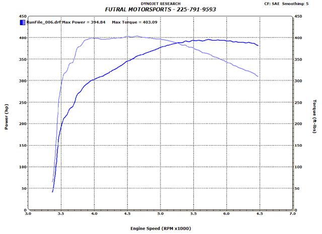

mildy built 370
Heres the setup:
10.5 to 1 compression
01 Lq4 6.0 bored 4.030=370
speed pro hyperutectic dish pistons
stock rods with arp bolts
243 heads milled .030 with valve job
224R cam
1 3/4 LTs
Stock truck 78mm intake
full exhaust..no cut out
dynod with 3.90 gears 3200 circle D stall on factory 20s
3RD gear pull locked convertor

That was pretty close to what you was shooting for, wasn't it? I still haven't hit the rollers on the 370 I have. still try'n to fine tune.

Yep I wanted 400hp from the build
Curious to what yours does.

Nice number. Bet she runs good.

That's pretty dang good. Congrats.

Power is right where it should be. Nice job!
My 6.0 is jst like your 370, but it has ported 243's and 10.7:1 compression, so after seeing your results, i'd say it's safe to say i'm sitting right around 400rwhp also. Good to know!

Pump gas?

93 octane pump gas

400/400, nice flat torque. Love it.
