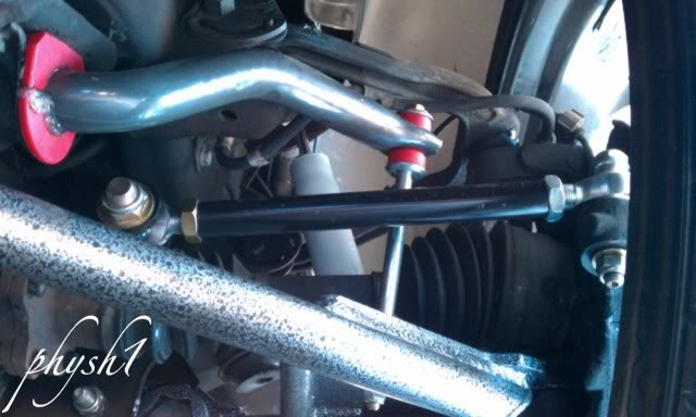

I cant post a picture from work but I have slicks on 17x9s with a 28x10.5" slick. I have coilovers in the front and heim tie rods. I like my coilovers way more than with the straps; no need to constantly adjust them and the ride is way better.
Is that what you are running?

Not exactly, but similar (same concept). The kit I have I think is an early model. The biggest issue is the tie rod bolt to the spindle is tapered, and finding that tapered bolt is not easy (I never found one), so I ended up drilling out the spindle for a large straight bolt.
