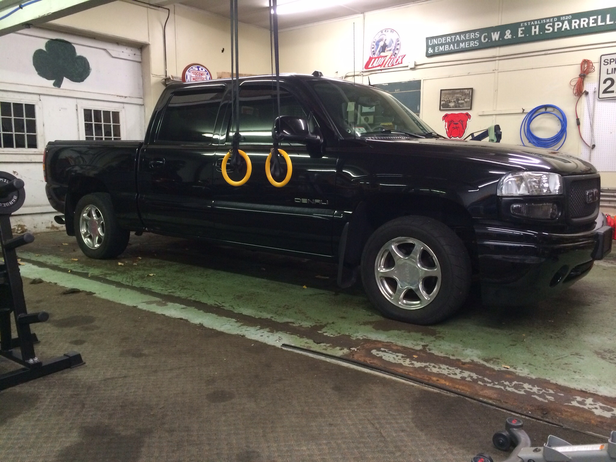

I run stock denali wheels with the m&h 275/50r17. 2 of the tires are more or less shot so when the time comes I'll get 2 race stars 17x9.5 and run the 325 out back.

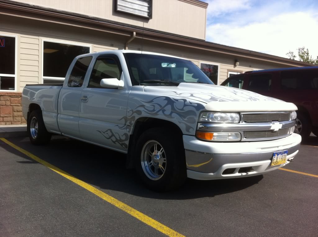

M&H Racemaster drag radials on Centerline billet wheels, and a little bit of suspension work. Any questions, just ask. Yes it's a 4x4.

AK truck looks good! What size tires? What do you have for lowering? I want to be sitting at about that same hight.

275/55R16, which is a 28" tire. Wheels were 16x8.5 IIRC.
Out back, I had lowering shackles, removed block, removed overload, and CalTracs. Up front I had lowering keys, aftermarket UCA eccentrics, tie rod sleeves, and adjustable limiting straps. It was around a 3/5 drop.
