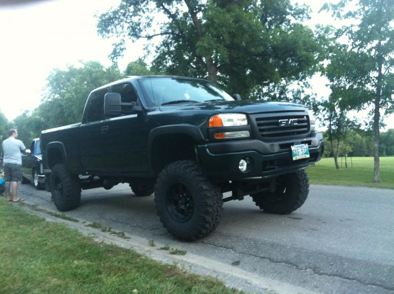

GREENSIERRA's Avatar
Joined: Mar 2006
Posts: 1,092
Likes: 69
From: Canada
:p

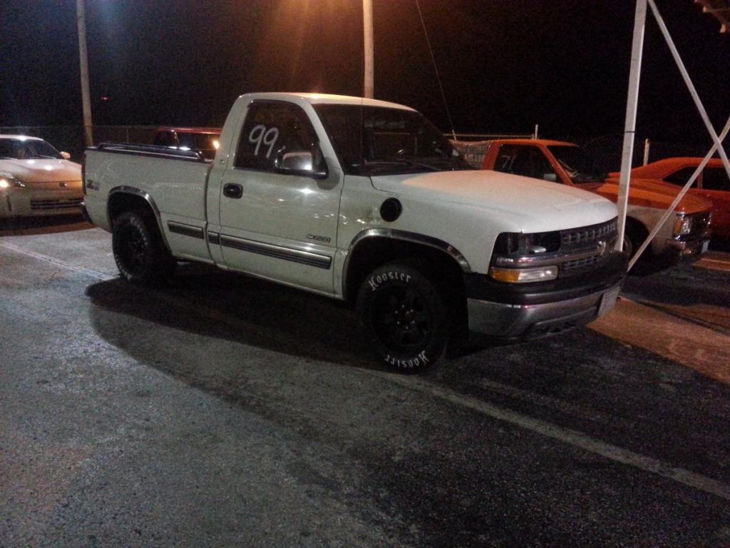

Atomic's Avatar
I have a gauge for that
Posts: 16,282
Likes: 438
Turbo was a bw s482 and converter a low stall ptc 10.5" triple disc
