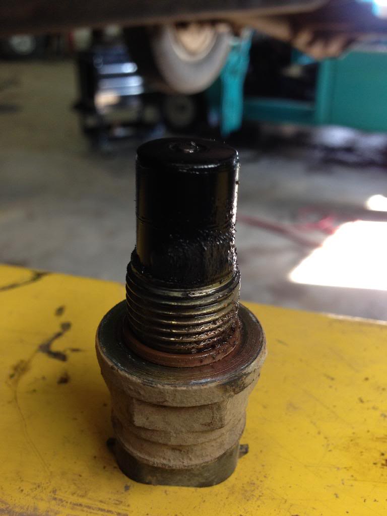

ive had this problem on several of mine aswell. its 99% of the time the screw in activator switch on the side of the transfer case. when you pull the lever insidethe cab, it enguages the transfer case and then that switch enguages the front actuator. replace that switch and you should be good to go! its on the driver side of transfer case towards the upper side. its called a (transfer case switch)

how much was your new one? been a while since ive bought any and dont remember. they were always fairly cheap for what i recall.
Old Mar 3, 2014 | 04:36 PM
Chevy_King1500's Avatar
Joined: Mar 2011
Posts: 2,072
From: Jasper, IN
didnt get the new one yet. so thats the right part?
Old Mar 3, 2014 | 04:37 PM
BigBlock90's Avatar
Joined: Oct 2012
Posts: 566
Likes: 17
From: Denton, NC
yessir thats it

heres the right part
located on the driver side next to the floor shift rod..
you need a deep 23mm socket, its easiest if you go from the rear of the transfer case and reach over it.

working great now.
at first i couldnt see the switch because of all the dirt
