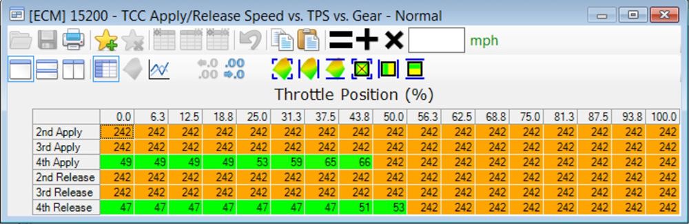

There is no set mph for converter lockup at part throttle unless a tuner set it that way which IMO would be dumb. In the table the mph for lockup varies as a function of what gear the transmission is in and TPS. And the tables will be different for different vehicles, rear gear ratios, and tire sizes. Some vehicles are programmed to lock the converter at a set mph in certain gears at WOT. There is really no right or wrong.unless locking it too early or in certain gears causes bucking or drive ability issues. Locking up some aftermarket converters at WOT can damage them if the converter is not built for WOT lockup. Also most stock converters for A6 transmissions are programmed for 20-40 rpm of slip when locked up. Not all aftermarket converters will tolerate that and TCC slip should be programmed out.

I have mine programmed to lock in 3rd or 4th only at 50 mph.

Mine locks up in 4th only at 49mph... or until I hit 243mph

Most of the time with a higher stall converter, you need to raise the lock up MPH at low throttle conditions to prevent harsh lock up and bucking. Comparing RPM and turbine input speed are good indicators of slippage and when to lock the converter.
