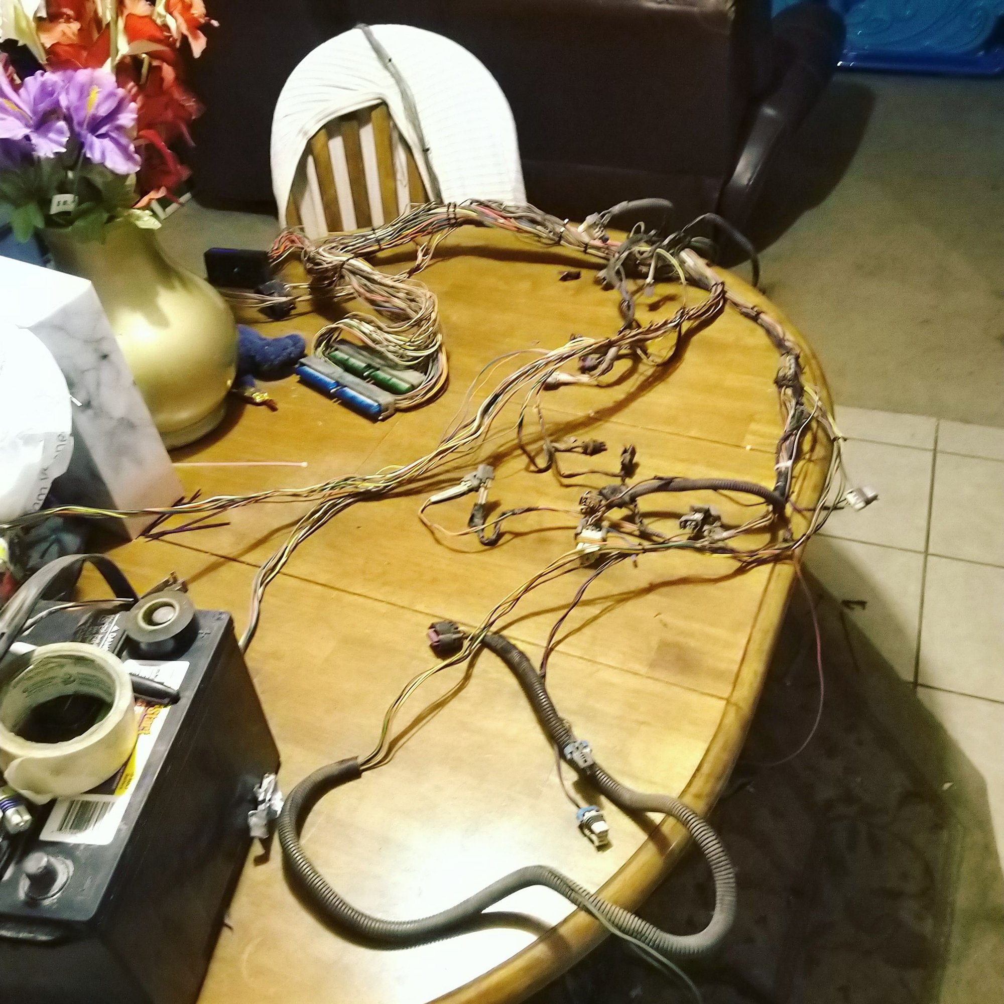

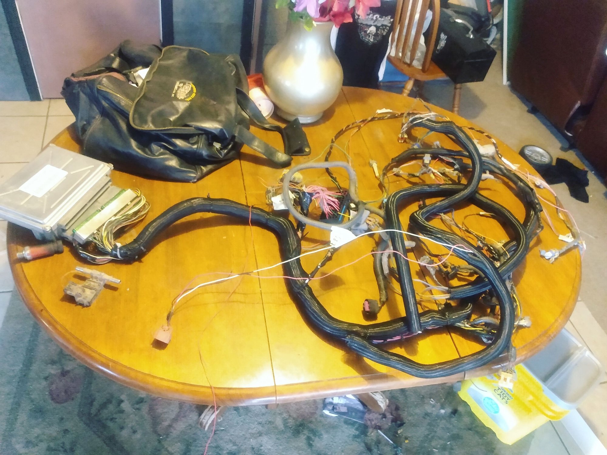

Old Feb 28, 2020 | 09:22 PM
bbowerman's Avatar
Joined: Jul 2012
Posts: 138
From: Tulsa, ok
Old Feb 28, 2020 | 09:25 PM
bbowerman's Avatar
Joined: Jul 2012
Posts: 138
From: Tulsa, ok
Here are some pics. Just gotta change my injector pigtails, modify c2, c100, and c152 harness and get some small loom to finish it up. Took some time to do but this will hook directly into the Silverado fuse box. Plug and play. Keeping the stock gauges,a functionality and HVAC capabilities. will update as I get further along.

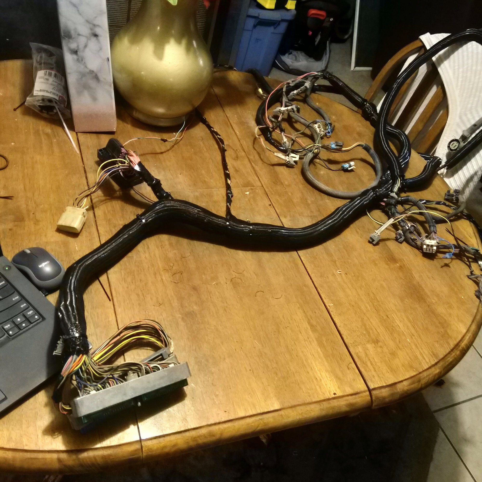

Old Mar 16, 2020 | 04:54 PM
bbowerman's Avatar
Joined: Jul 2012
Posts: 138
From: Tulsa, ok
Here it is with the flex fuel composition and all. Every factory gauge and bcm function will work. I will say it takes hours of time because the body harness is different every year. Certain wires had to be added in, some had to be taken out, and some just had to be moved. I will start putting the truck together this coming weekend. It's a turbo 5.3 4l80 rcsb 4wd street truck this is going in BTW.
