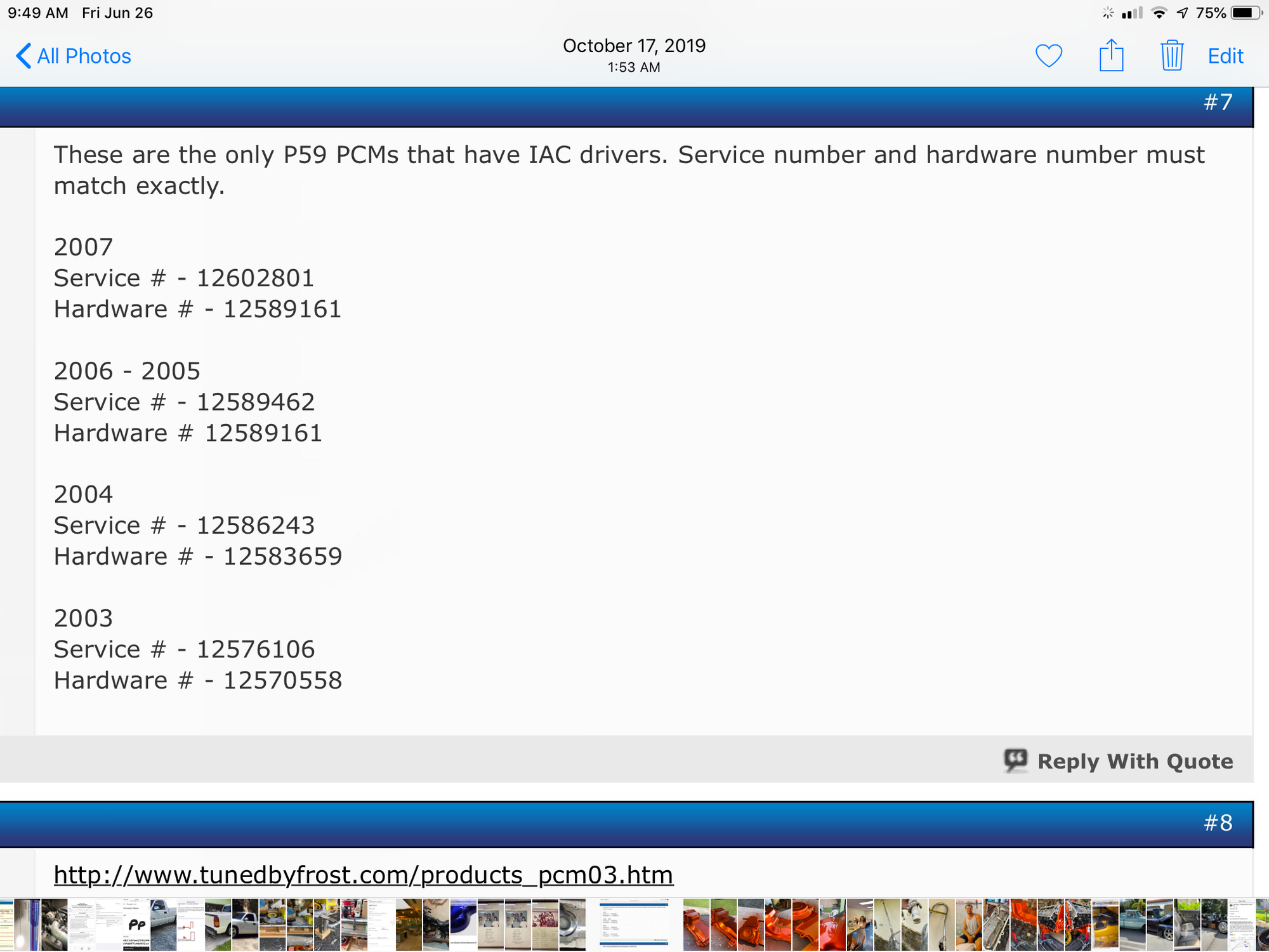

Great post guys. I’m just finishing 99 RCSB from v6 to 6.0/821 moded On3 hotside VS gen2 7875 A2W
w 4l80e
i using 99 LS harness with P59 pcm with DBC , 3 bar and e85 . But here’s problem. E85 on in HP tuner but it’s not reading.. what pin are you using for signal wire on e85? I’m using pin 56 from writeup I found here on PT.net . It either I’m pinned it wrong or not setup right in HPT .. unfortunately I’m only beginning to learn HPT. I have Good local tuner tuning truck. Only at 9.5psi on 93 on street so far... here’s list of P59 that have. iAt for DBC.
