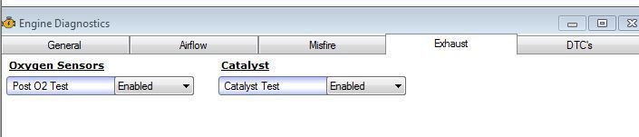

Not sure if they do anything, but have you tried setting these to Disabled?
I did, they didnt work for ready tests. Just shut off check engine lights and codes.
