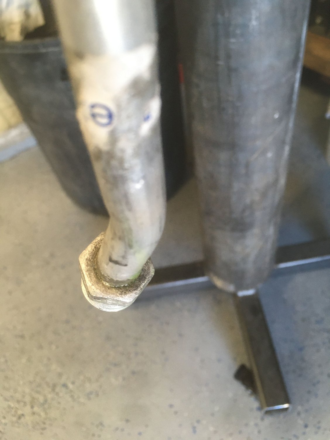

Coolant leak and PS leak seem to be fixed via tightening clamps more
Exhaust leak is going to get wrapped in copper foil and reclamped. Hoping the conformal foil will help the band clamp seal
AC leak is a failed braze joint. Going to sweat that fitting off, clean off the braze and weld it up. Because #welderlife. Not going to deal with the return and BS of that hassle. Can fix it in the same time I'd probably need to write the return info up

Won't the rear main seal leak eventually quiet the throw out bearing by lubricating it? And help your clutch slip by soaking the plates in oil? You have to look at the positive side of having a leak.
And is your condenser steel? Or did they use alumaloy to braze it?
Old Jun 29, 2022 | 09:13 AM
  #88
arthursc2's Avatar
Joined: Jan 2014
Posts: 4,341
Likes: 1,517
I actually don't know what it's brazed with, it's a black color braze though. Maybe epoxy?
condenser is aluminum

I had to look at my aftermarket aluminum condenser last evening. Duh, of course it's brazed. How else could they join those tiny tubes to the headers. They must furnace braze everything at once.
I'm interested in how you go about repairing yours.

Real-time repair, condenser is out. Here is the leaking POS
