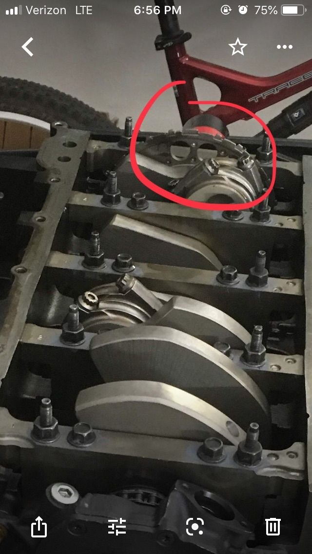

Google photo and I figured it out
reluctor is on backwards. Thanks TSP.
Edit: comparing this to my LS6 crank, it may not actually be wrong 🤷‍♀️
So lost

Got a picture of the cam wheel on the motor?
If the 24x Crank wheel was on back wards it would not run. Just happened to some one on LS1tech in the past month. The shop he used put it on back wards.
