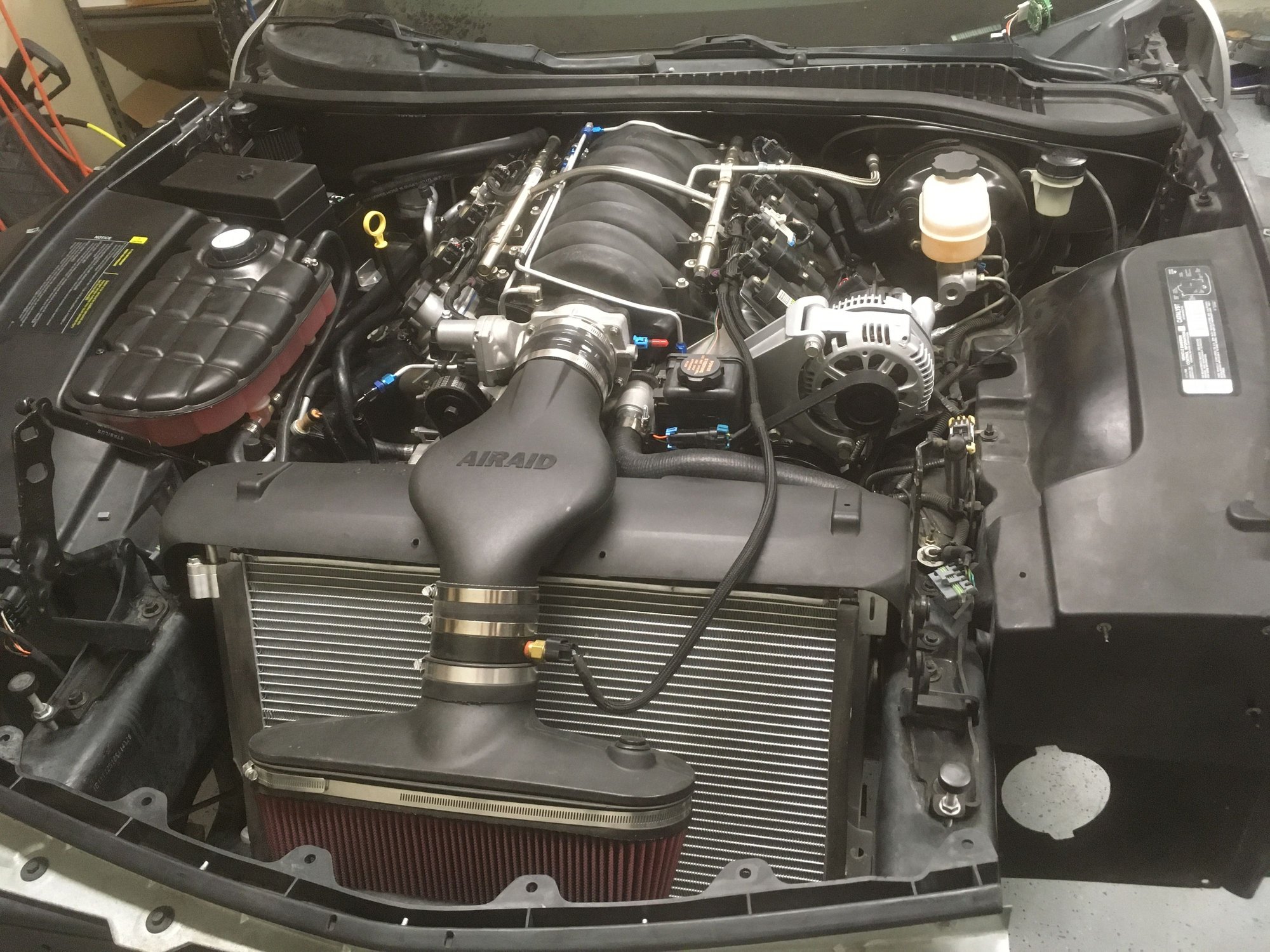

Alright, I missed the track event buts that's ok. A very special lady friend of mine really wants to drive this thing and that's the real motivation if I'm being honest 🤣
but, without more babble and bullshit; SHE RUNS!!! She sounds rowdy as **** too. Revs to 5500 easily, and sounds great on the way there and back. I might have a little lifter noise, or it's just the rockers and dual wounds
I unplugged injectors and coils and she drops a cylinder each time. Tried to do a crank relearn, but Tech2 was like nah fam. No codes except air bag (expected) and MAF (expected). Everything checks out and the dash is actually happy!

On the Crank Relearn, Is it not stopping at the specified RPM cut off or is giving an error?
Old Jun 20, 2022 | 01:56 PM
  #69
arthursc2's Avatar
Joined: Jan 2014
Posts: 4,341
Likes: 1,517
Didn't stop at specified RPM. Tried it 2x and said meh it's running, does it really need this?
