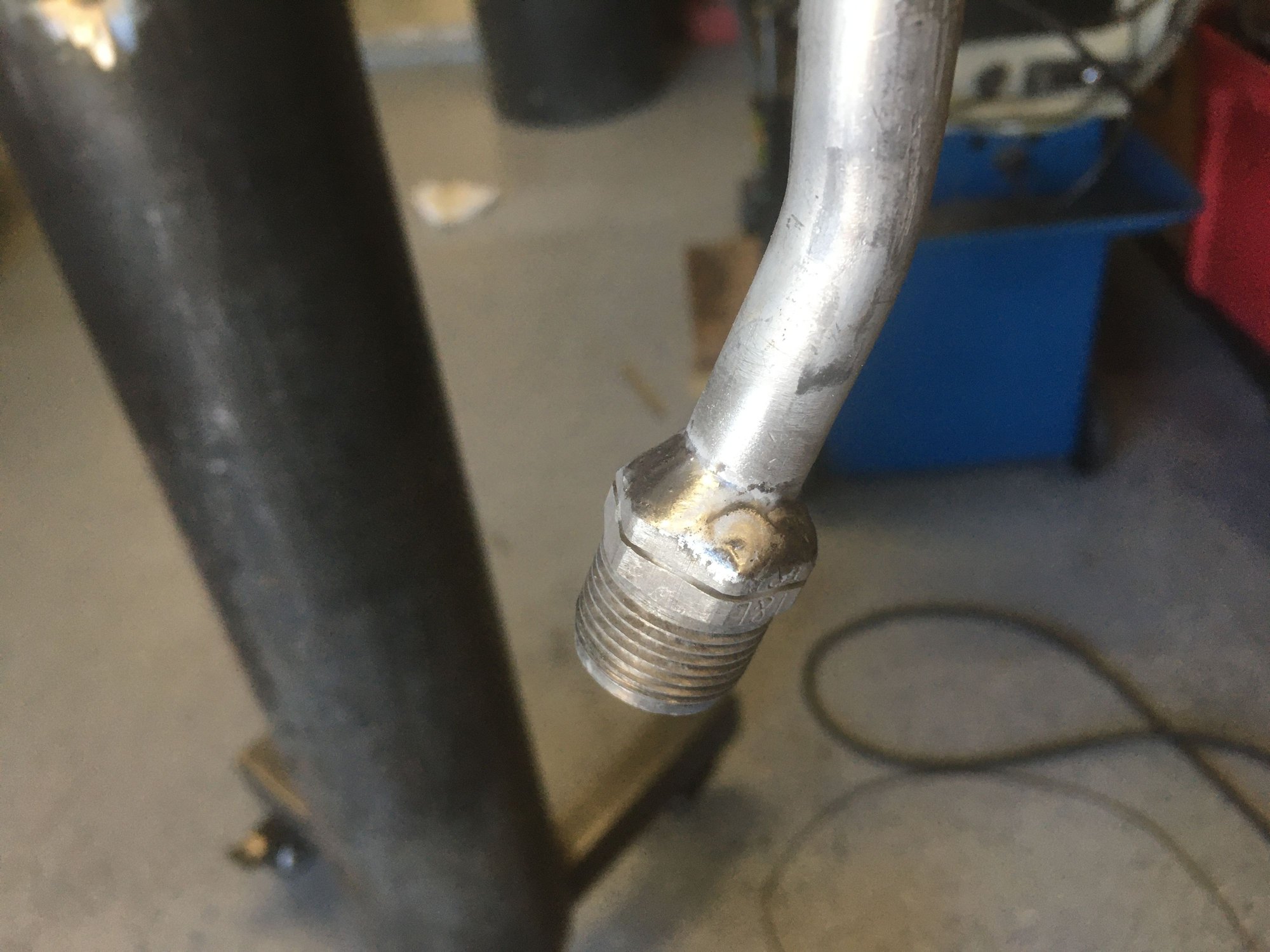

All cleaned up, about to do a test arc

Arc? So you TIG brazed it? I had no idea that stuff works on aluminum.

TIG welded with 1/16" 4043 filler wire. 100% argon shielding gas. Preheat and cleaned with acetone

Oh. Good job camouflaging it with the brassy color in the picture

I think that's just a reflection of her underside of my weld table. When I have the car in the air later this morning to finish the fender hardware, I'll send you another pic. It's silver in real life
