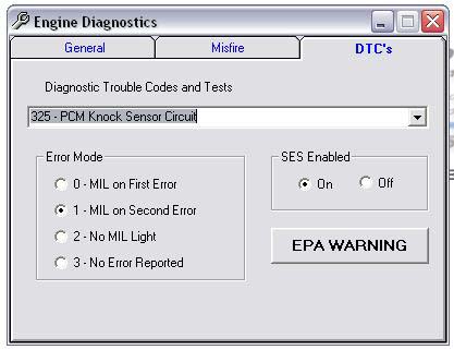

HPT has a screen where you can take a code and choose how the PCM responds to it. See attachment...you can change the response to any DTC code.

yep, as stated above, you can use the aforementioned programs to make it either not set the ses light, but still take note of the problem or you can ignore the sensor all together... sounds like in your senerio this wouldn't hurt a thing.
