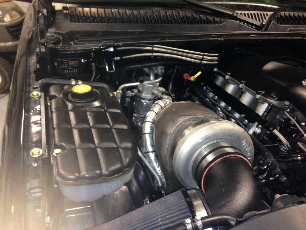

I used a C5/C6 tank.
Hey man just curious why'd you switch from the Aveo tank?
