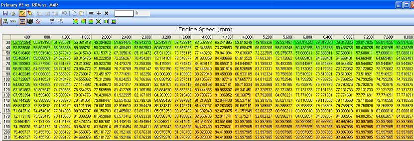

Sorry I was thinking about a different OS. I had to alter a VDF once a while back
This is from a 2004 1 meg PCM
2 bar
3 bar
This is from a 1999
The 3 bar
2 bar
Attachment 61680
3 bar
Attachment 61681
This is from a 1999
Attachment 61682
The 3 bar
Attachment 61683
well damn, it doesn't grow. well i guess at least out of boost range its still 10kpa. so part throttle should still be ok. is there any os's i can over ride to my pcm that would work to get a better resolution?
I had one that grew, but I am not sure what it fit now. I guess I could have had an issue with the tune and it didn't grow. It was a few years back
