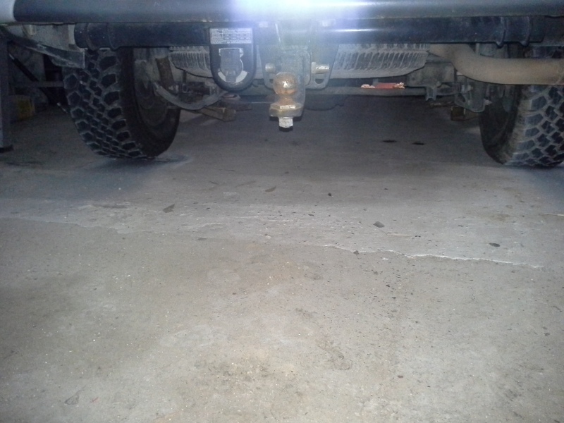

First thing i did was see if it would spin the tires... test passed
Took a Spare 2wd 4L60E i had in the shop and swapped the output shaft for a 4wd. Threw it in monday night and fired it up last night. Checked the fluid and it works.
240,000 miles and the 5.3 is really really quiet at 550rpms. Injectors are loud but i was expecting the piston slap.
