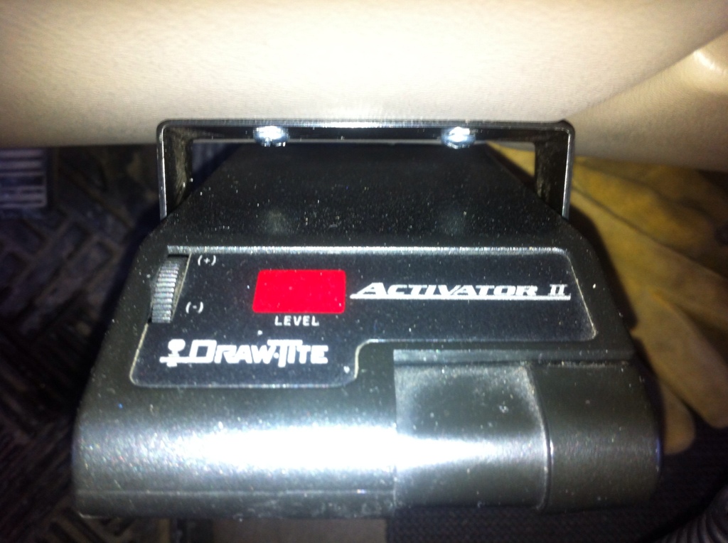

I have a DrawTite Activator II in both of my trucks. Simple to install, simple to use, and wasn't expensive. Can control single, double, or triple axle trailer brakes.
