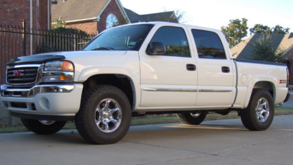

I'm running them, no rubbing at all, I have 17x9 rims with the Nitto's.
Yes I cranked up the Torsion bars.
Attached Thumbnails 295/70/17s  Will they fit??-truck-1.jpg
