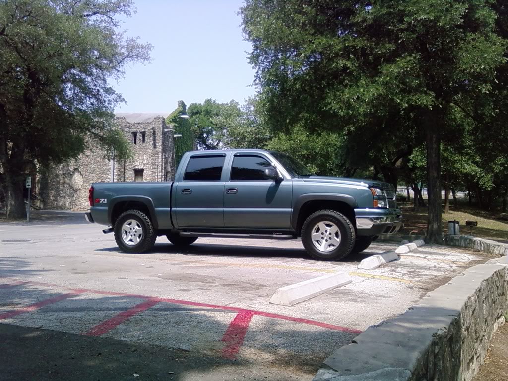

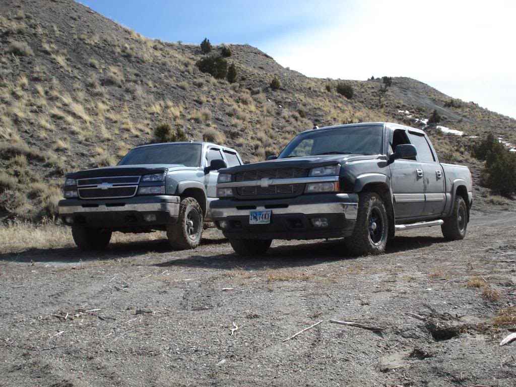

i didnt measure but if got pics lol.when it was first done the front sat higher than the rear so i had them lower it a little (1" i think).
stock-265/70/17
leveled-265/70/17
leveled-285/70/17with lower airdam removed
same as above but with current wheels
a buddies stock height truck next to mine,notice his lower airdam is still on
stock-265/70/17
leveled-265/70/17
