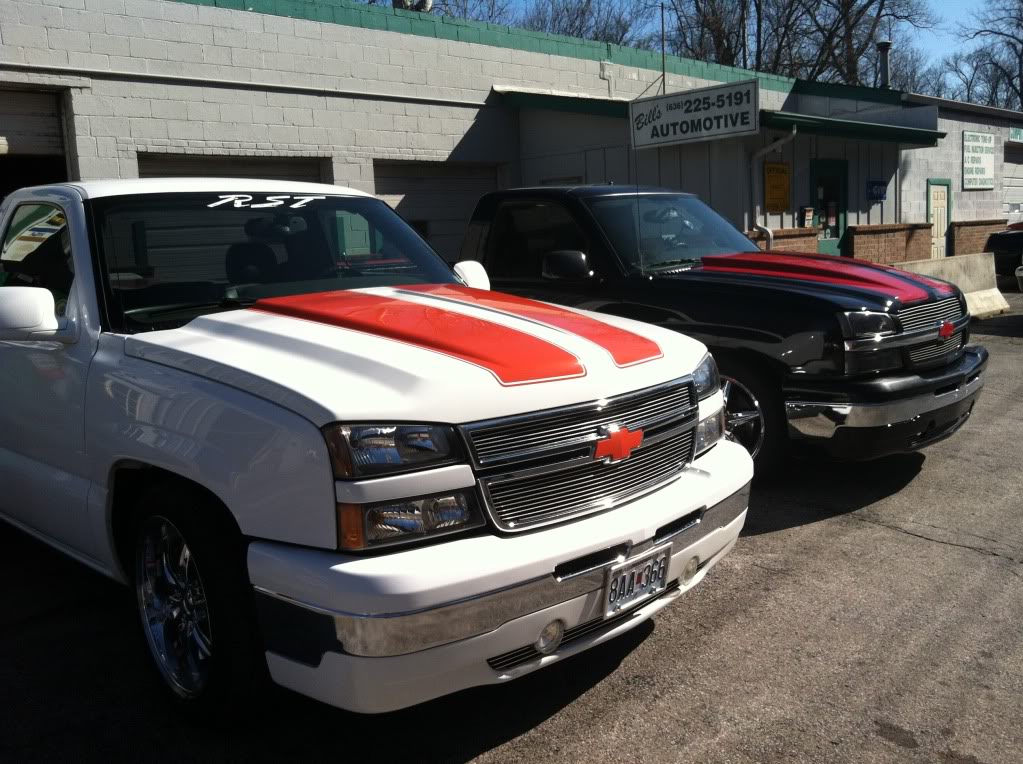

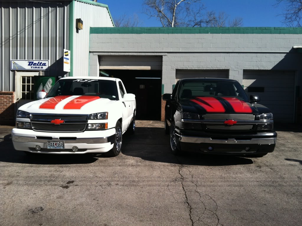

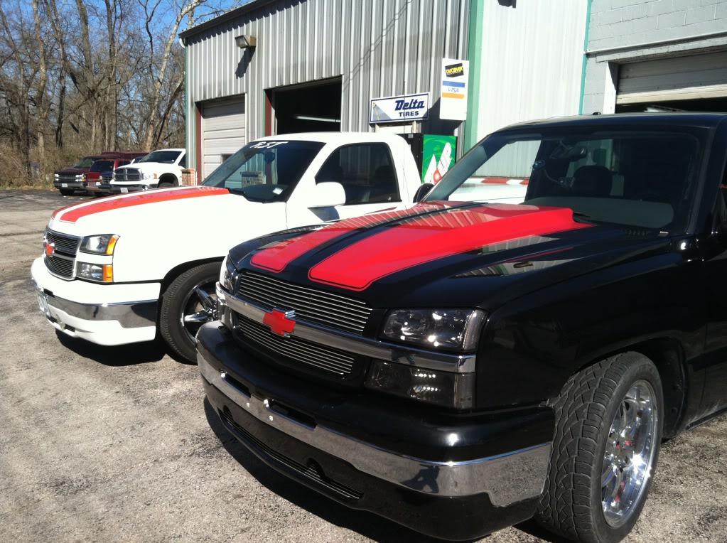

Me an RstJoe's (RST's) lol when I went to MO to pick up a tranny I bought from him
