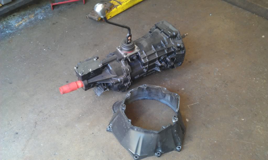

I have a T-56 with the Keisler midshift kit. Not gonna lie, its not an easy swap. I did it for a Sonoma I had and have been thinking about putting it in my truck. And based off of my measurement, it is about 2" off still but a hell of a lot closer than not moving it. It's a very good kit. From what I can tell it is also a sudo short throw.

very nice man, an yea i can live with that.. I have a guy who works n tranny shop here n Topeka and specializes in t-56. said he will do the swap for me including teardown and rebuild for $350 i just pay for parts... i plan on buying the Keisler kit n about a month when i get back from Vegas. Do u think i would be able to reuse the shift lever out of my RST?!?! if i just got a different ball for the 6 spd
