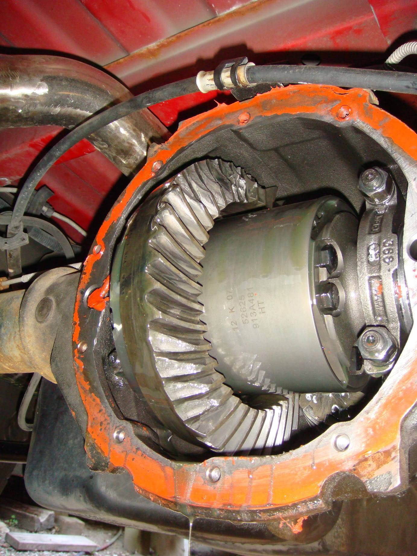

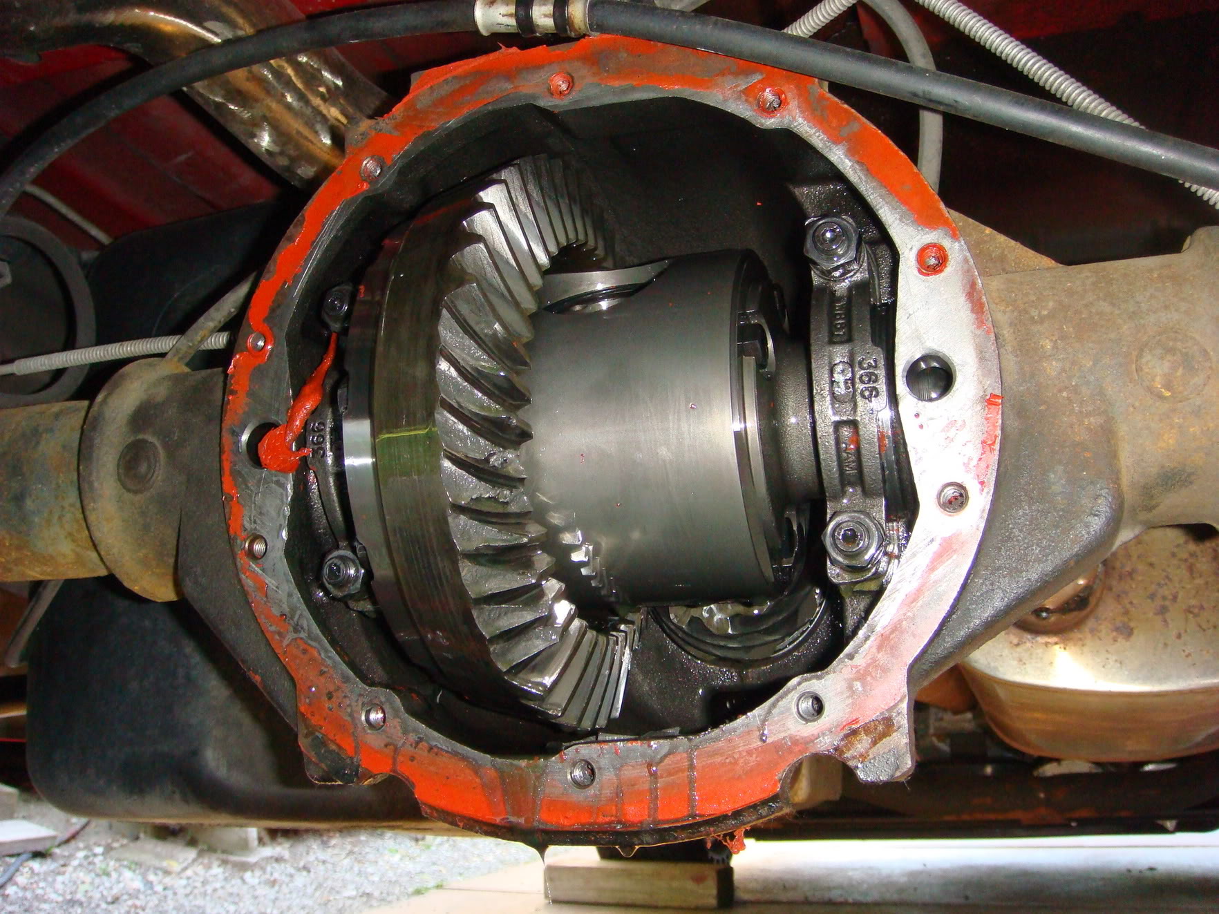

well weekend before last i went out to the track and had a little fun. the damn truck kept fighting me, the rep mode kept setting and then i managed to find a setting in the hpt beta to fix that. then the tune wanted to act up cuz my iat's were over 106* everytime i ran cuz with the problems i didnt have time to cool down so i was hot lapping it. then on my last run i get past the line and turn back to get my ticket and here this tick....tick.....tick. and im like WTF? get home and after a couple days i get to pull it apart and find this...
now i have purchased a set of 4.88's i should have done these in the first place.
vids to come soon.

damn that sucks sorry to hear about the tune bein unruly...at least a new set of gears won't set you back an arm and a leg...get that tune right before you go back out!!!!....any idea why that could have happend to the gear?

i didnt have set up right i guess. with everything that was going wrong this was the best run for that night.
