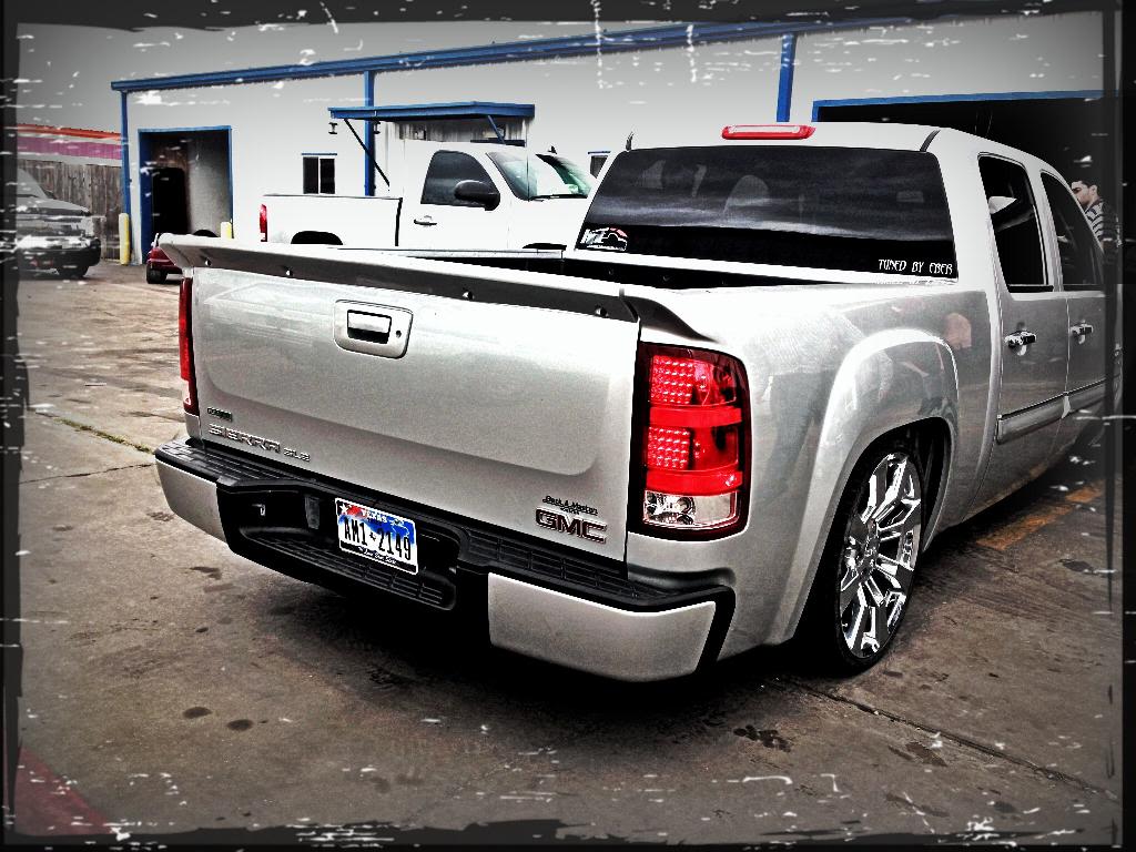

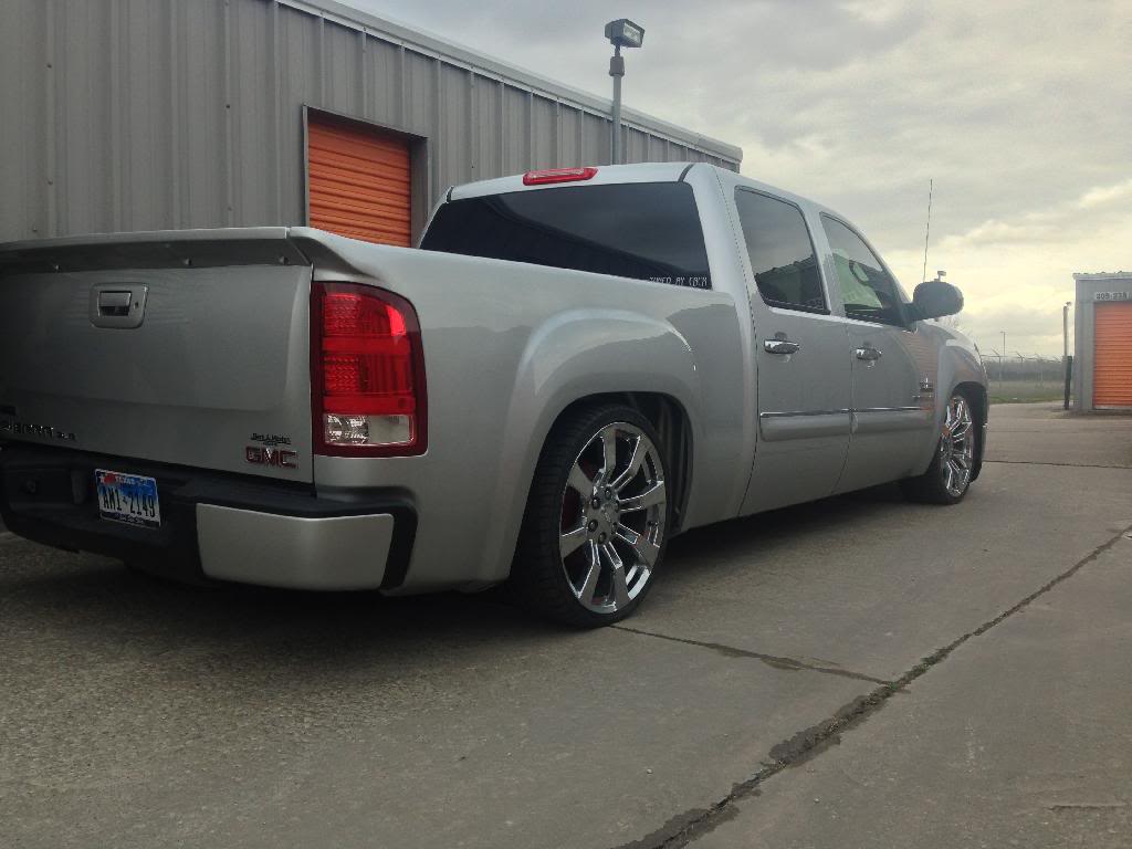

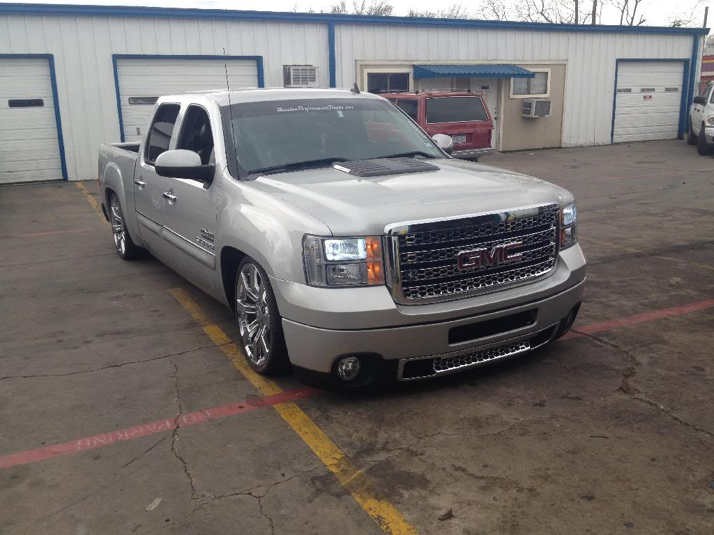

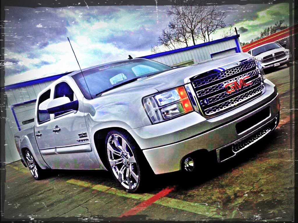

First off I want to thank TRD Tundra(member on here) for working on the front suspension. Also big thanks to the Draztik Changez crew for the HD Denali front end swap, wing molding and complete colormatching. Also big thanks to Jose (Hozzey) at Regicide for the rear suspension work. I recommend these guys to anyone wanting some great work done.
Suspension 5/7 drop:
DJM 4" upper and lower control arms.
Stock GM springs.
Adjustable Belltech struts.
Regular C-Notch.
Belltech street performance rear shocks.
7" McGaughy's flipkit.
Results:

Really like the silver gmcs. sharp looking truck

Thanks man. Like how the silver plays off with the chrome.

Clean and simple. Love it.

Wow that looks great.

That looks kickass. But is it even driveable? Theres very little room above the front wheels unless your tubbed.

what made you go with DJM up front versus Belltech's new spindle for drops of 3" or more? Just curious as it looks a little out of alignment.
Truck looks sick though and the molded spoiler makes me jealous that mine isn't done that way...

Yeah its driveable. It looks that way but the tire is a 265/30/22 soo it clears perfect.

Honestly I got a good deal on the control arms I couldnt pass up. And it looks out of alignment because it hasnt yet been aligned. Ill be going tomorrow or thursday morning for the alignment.
