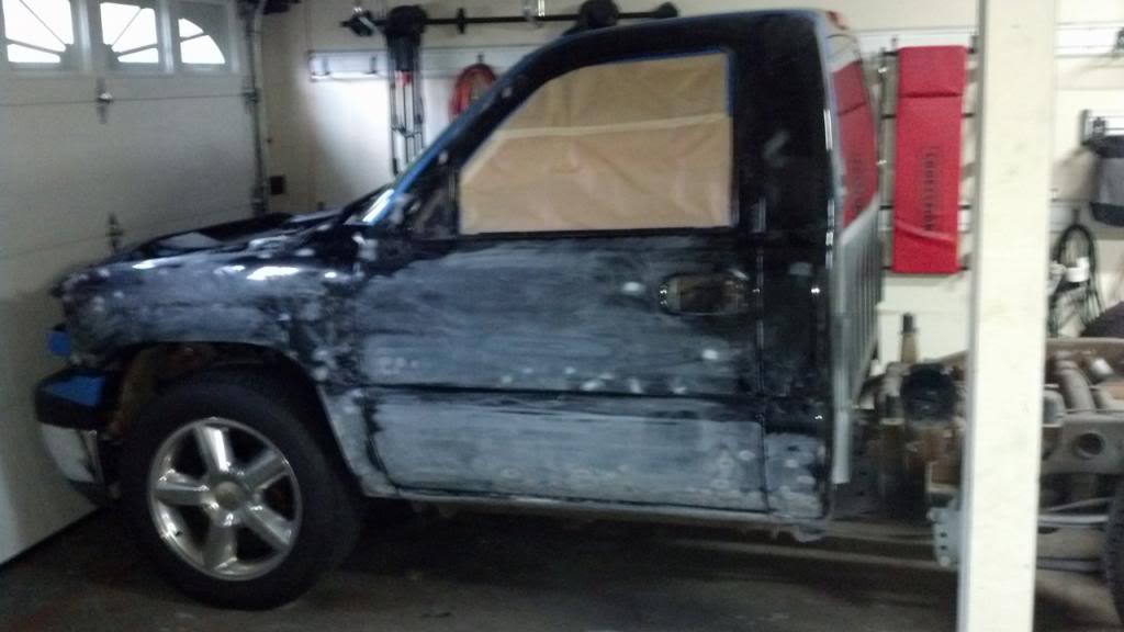

Started on the cab.
Got a nice dent in the fender to fill.

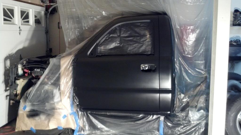

Thanks. I keep getting frustrated, then realizing it's turning out ok, over and over again, lol...
The dent in the fender pictured above got into the edge of the wheel well so I couldn't fill it. Found a good condition fender on CL for $50, went down and picked that up yesterday.
Shot the DS door and cab with epoxy primer tonight. Will try to do primer/surfacer tomorrow, block and maybe spray sealer Wed, then try to finish setting up a homemade paint booth and give base/clear a shot later this week.
