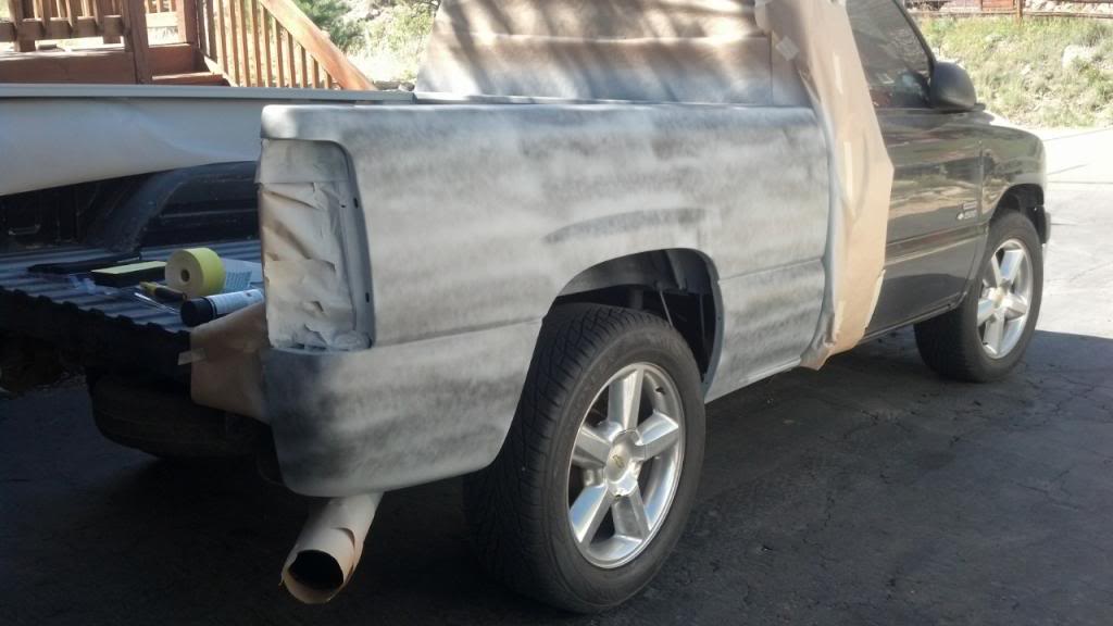

First primer/surfacer coat after spraying guide coat:
First coat sanded down, ready for second coat:

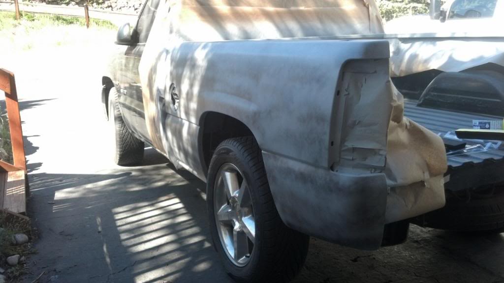

Second surfacer/primer coat on, guide coat sprayed again. Currently waiting for this to cure enough so I can hit it with some 400 grit, then on to the color coat!

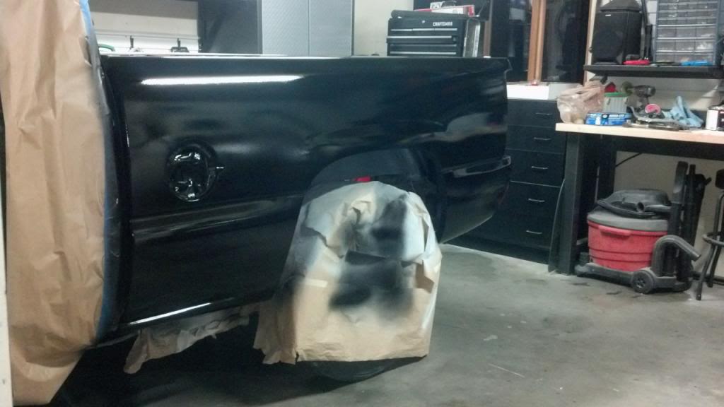

Well I cleaned the driver's bed side today, shot it with another coat of epoxy reduced with acetone, waited for it to flash off, then shot color. I'm going to have to rent some paint booth time or maybe just pay someone to shoot it for me, my garage just isn't near clean enough to do this. Might have gotten orange peel too, will have to see what it looks tomorrow after drying. I'm actually wondering if my primer coats were too thin, each one of them had quite a bit of texture to them like the paint hit and dried before it had a chance to flow together.
I think my plan now is to go ahead and prep the rest of the body, one section at a time, then shoot them with epoxy and leave it at that until the whole thing is done and I'm ready to paint it all in one shot. Then I can sand it one last time and haul it on down to the paint booth.

Doesn't look bad in the pic. If your primer was drying as it hit or before, it sounds as if it may have been to heavy, or to much pressure. Did you go with single stage or base clear ?
