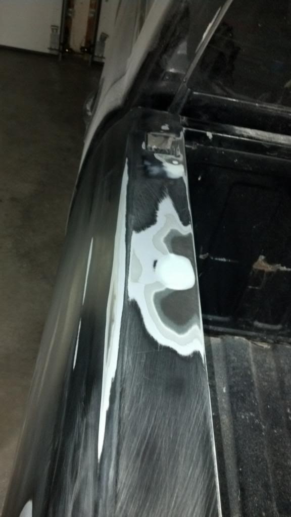

Here's last night's progress, after feathering out scratches/chips/flaking paint areas, filling the dent in front of the fuel door, and filling the two screw holes on top of the bed rail.
Anyway, now I understand why body shops are so expensive, this is a complete PITA. Will post more pics as the project progresses. I think I've decided on Cyber Gray as the eventual paint color, which is a factory paint color on the newer Corvettes. I'll have a cowl hood by then, still on the fence whether or not I want to do any kind of racing stripes. Maybe I can experiment with them a little bit using plasti dip.

Good progress, keep it up. Also just to save you some money and time, you really don't need to put plasti dip over the areas you've worked and are ready for paint as long as there's primer on it. It will be fine, I've been driving my 01 around for a few months with a primered cowl hood and tailgate and just now starting to paint them.
I'd just dust some spray can primer over the worked areas. It'll be fine and the whole thing will have to be sanded again anyway. It'll be a hell of a lot easier than peeling off plasti dip.
Love the new color choice BTW.

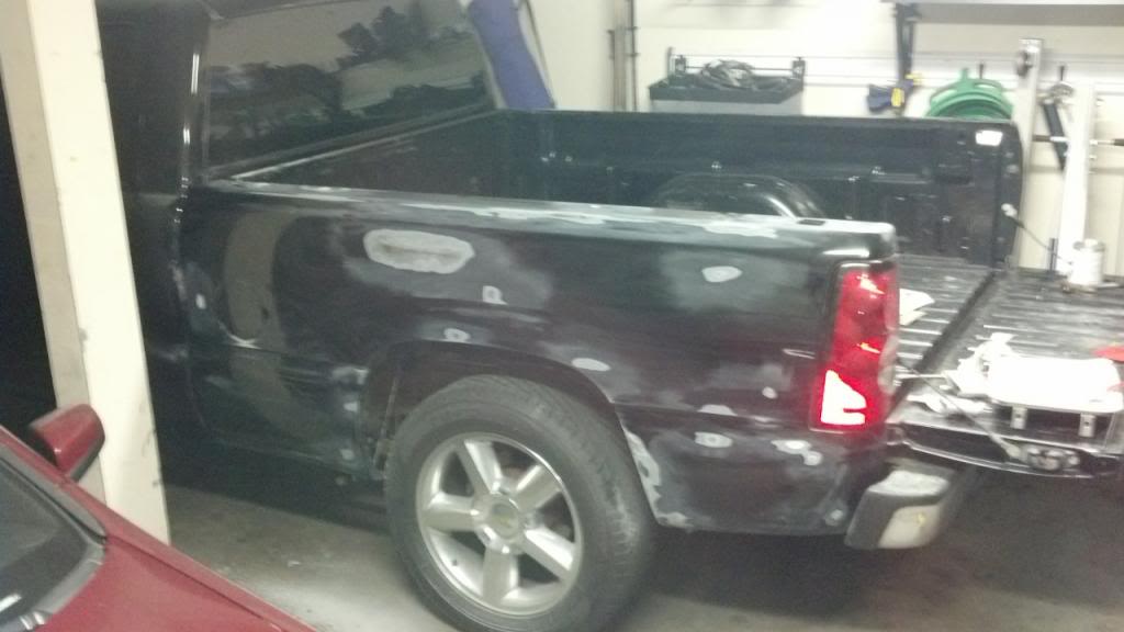

Thanks guys. I'm going to go ahead and do the PD for now, I'm not taking the truck completely apart yet so when it comes time to do the actual painting I'll be taking off the bed, doors, fenders, and hood to get into the smaller and concealed areas. I'd like to actually prep those areas before priming, and I'd rather do the primer with an actual spray gun rather than rattle can if possible. The PD comes off pretty easy, I had sprayed my fuel door and tailgate last week, and just peeled off the fuel door yesterday. Plus I'd rather drive around with flat black than primer color, and I should be able to see any imperfections under the PD that I can fix after peeling before spraying primer.
Anyway, here's tonight's progress. Left bedside is ready for spray. I have a total of probably 6 hours of work into it to get to this point. Definitely understand why body work is so expensive, it goes really slow.

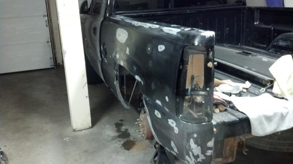

I went and bought a Makita DA sander this afternoon...I couldn't have done another night of manual sanding! My shoulders are starting to get sore from last night already, lol. That thing is awesome with some 80 grit paper on it
I think it took longer tonight because I did most of the work with a 220 pad on it, thinking it was 80. It wasn't until I was almost done sanding out the chips that I realized I had the wrong one on there.
